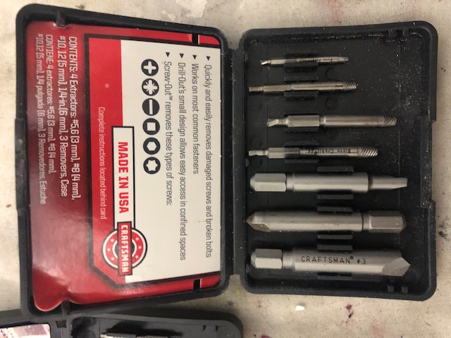

As far as removing the screws, when doing the ground up restoration every wing panel screw had to be removed with easy-outs, this took me 40 plus hours over a few weeks. I found the craftsman easy-out kit the best, it came with 4 sizes and I always used two, I broke quite a few so I have about 8 kits with some missing, (luckily I was in the states a lot and I became Sears best tool customer over a few years). Doing it this way takes time but worked the best as you didn’t damage the thread.

A photo of what I used. Used the drill bit end to drill into each screw, then reserved the bit and inserted the threaded end with the cordless drill in reverse, have a low setting on the drill, don’t forget to spray the day before with Inox or some sort of lubricant.
