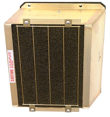

So what did the duck say... well he said that you can save a bundle is you go replace your filters with the Brackett ones... aviable at local supply houses...
Ahhhh but, which ones...
Well if you have a normal asp 337... A-K series... then you want the .... BA-111 kits... to start... sells for 38.95.... now before you go off ranting and raving tha it is what the other cost from cessna... these are a little different... they have a replaceable element... that can be cleaned... in them... yep you can take them out and clean them with gas ... re coat them with stuff that they used at the motorcycle shop to keep them from catching fire... and improves the filterablity of them... its kinda a green sticky spray.. stuff... that coats the foam rubber...
But,,,, do you have to get messy.. nope you can replace the element instead for a meer 14.25... it has a part no... BA-24... but, for a couple of nickles of gas.. and a can of green goo... you can do it for less than a buck.... if you don't mind getting dirty....
Ahhhh but, Larry says I own a new improved rocket ship that used to resemble the P-337... and they use the same filter ?????
Nope larry sorry they are different... from the normal asperated engines... matter of fact they are different from front to rear... with the rear one now being certified as a PMA replacment... it carries a number of BA-5810A... but, it also has a replacement element with a number of BA-5805... and its cheeper than the normals filter element... yep it comes in at 9.25.... if you want to replace it...
But, alas.... larry is stumped .. shaking his head... saying ... what about the front engine... well here relief is not around yet... Brackett over in Arizona is working on the problem and is awaiting certification... but, it hasn't happend yet... and you still have to use the paper high priced multi-stickered cessan rip off one...
Oh... what to do....
Well you might call or Email the manufacture and tell him that you have a need for his product... and he just might light up and get one out the door for the P series fwd engine...
