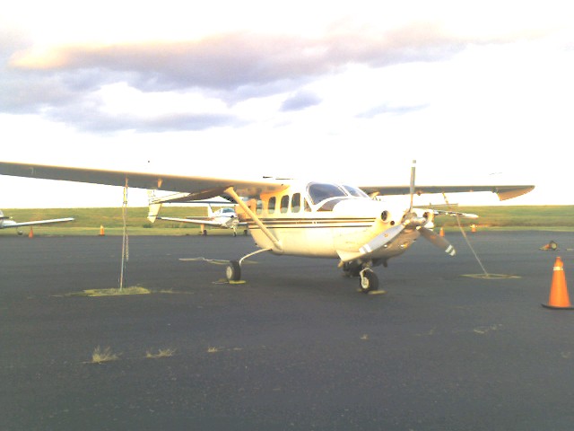

Some phone camera pix of the p337 with TSIO 550s. Obviously all the work is prototype.

Thank you for posting the pictures.
It looks like the intakes for the front engine are smaller than I would have thought. Also, it looks like there is a supplemental intake, on the front engine. The rear engine looks just really massive.
thank you again for posting the pictures.

The front engine cools very well and the rear engine cools better than the front. Last Friday as I was climbing to 17,500 and noticed the rear engine chts were starting to creep up. I realized I left the cowl flaps closed and the engine immediately cooled down when I opened them. By the way, there are no cowl flaps in front, just cowl outlets/exhaust pipe fairings similar to the Piper Malibu.
