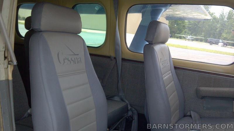

On the final phases of the interior refit, need some assistance. On the "G" model it has two aluminium extruded mouldings down each side if the interior, these mouldings are used to hold the plastic window mouldings in place.
They have a what seems to be a fake woodgrain strip glued in the centre. I will attach a photo from another aircraft where you can see the moulding I refer too.
My question: Does anyone know where to obtain some of this fake woodgrain strip?

http://www.metrorestyling.com/Wood-G...ilm-s/1228.htm
https://www.vinylgraphics.net/produc...d-Grain-Vinyl/
http://www.ebay.com/itm/Wood-Grain-V...-/261293995167

Appreciate the info, vinyl may be the direction I have to go. Current woodgrain strips are approx 0.8mm thick and don't seem to be vinyl.
Not sure if the strips in mine are original as it had an interior refurb back in 2003 (I am changing color and using real leather this time) since then it had only done 103hrs when I bought it as a project in 2010. I do have a couple of spare aluminium mouldings still with the original woodgrain from another aircraft, time to remove it to see what it is made of.

Dave at Sky Mac, give me a call or send me an e-mail. I have some of the "woodgrain type strips" from aircraft we have parted out.
Don Nieser (02 and 337 parts guy)
Commodore Aerospace Corp
405-503-4686 cell phone
