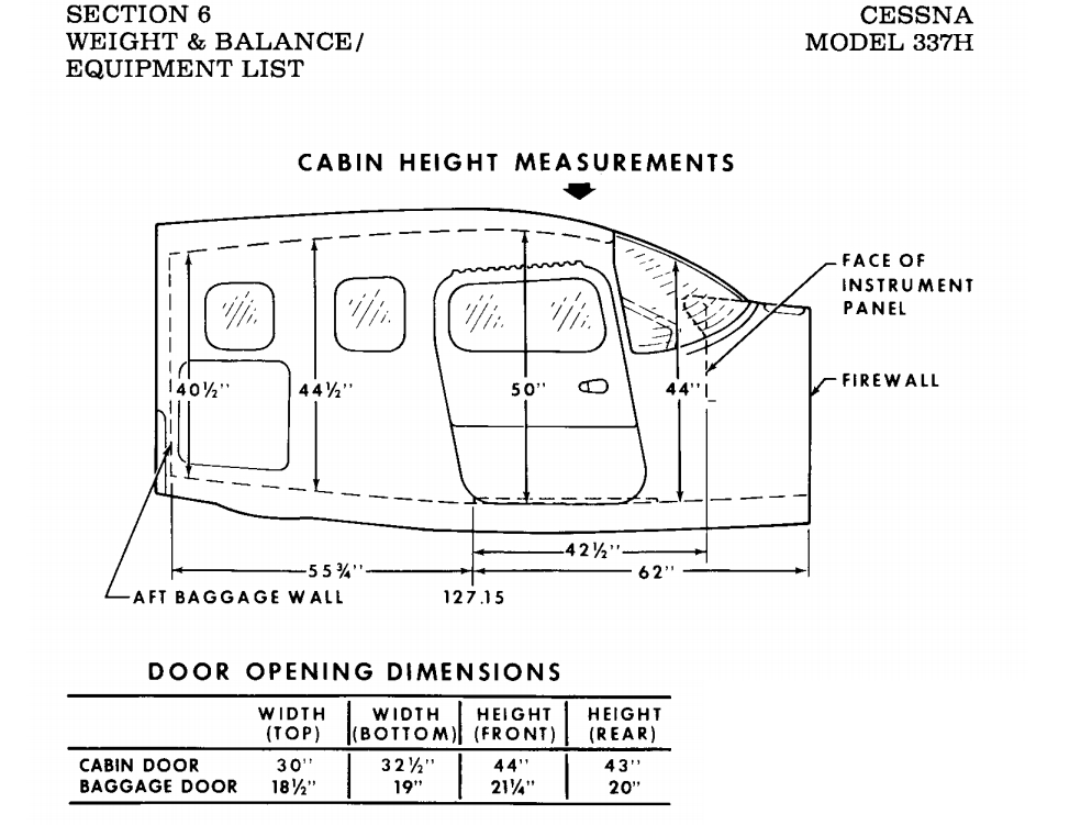

Hi all.
Was wondering if anyone knew this off-hand. Did a search of the subject and then for "size" in place of "dimensions" -- bupkus. So, I was hoping someone might know, or otherwise be standing next to their baggage door-equipped aircraft and reading this thread with, as luck would have it, a measuring tape in-hand.

Model H baggage door is roughly 18-1/2 inches wide by 20 inches high. See attached.

Thanks. Very helpful.
