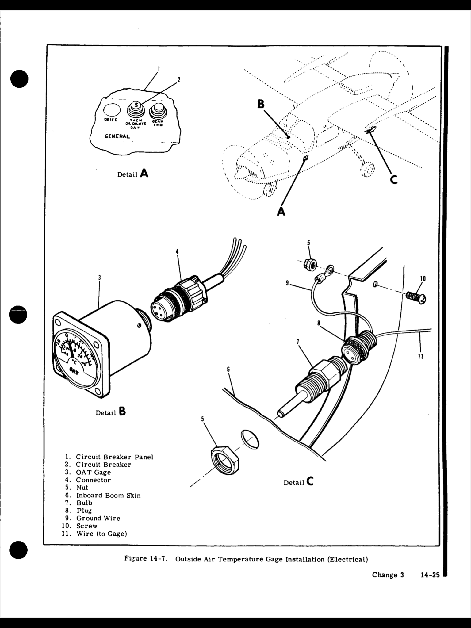

Sorry for the confusion. I have the probe separate from the gauge. The probe is on the left strut brace and of course the gauge is on the panel.
