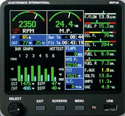

What about the EI MVP-50?
http://www.buy-ei.com/EI_MVP-50_Glas...or_Display.htm
seems to do everything, though you would need 2 of them, one for each engine.

I've called EI on their nice display. As of yet it is not STC'd, but would be a fairly easy field approval. Also, two of them are a REALLY tight fit. They really take up alot of the Skymasters real estate if mounted in the prefered configuration of top / bottom. Side by side is a differant story.
