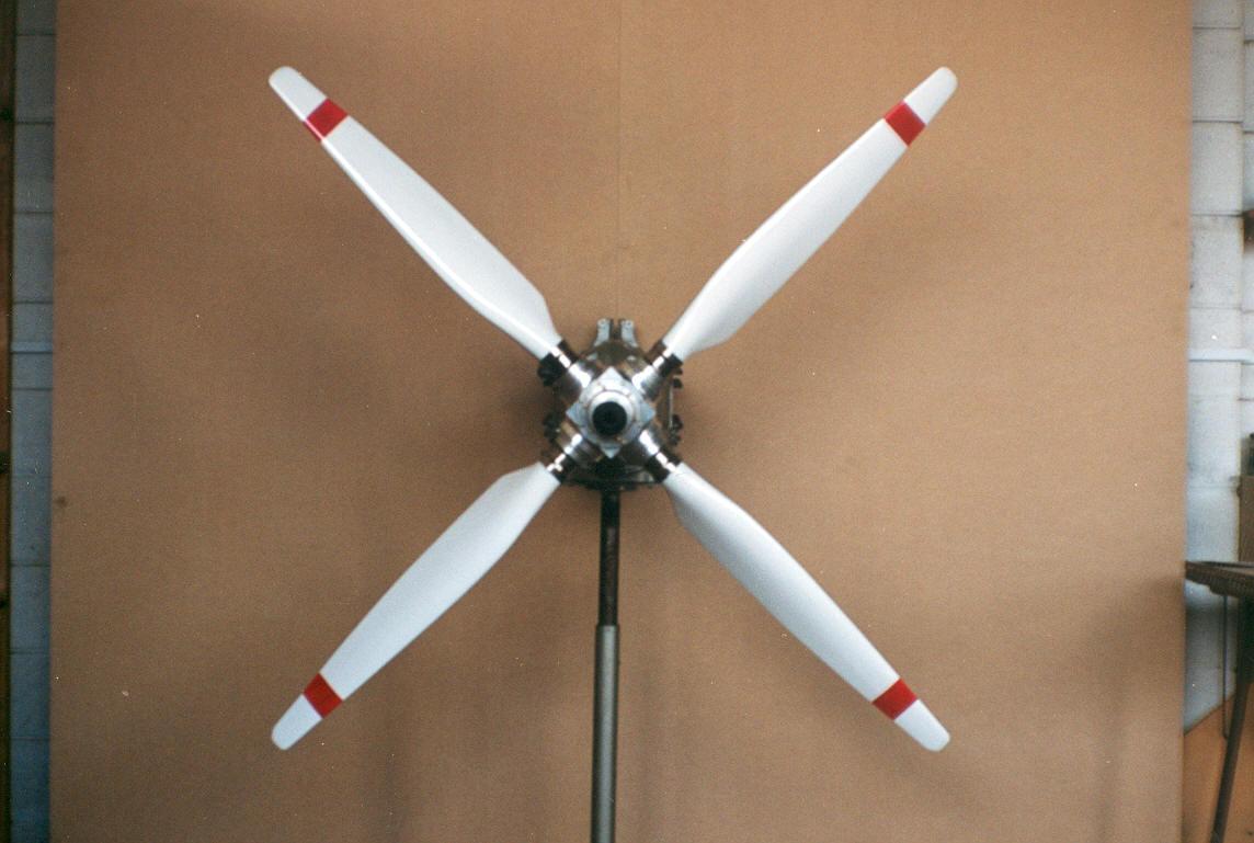

I'm working on a STC for a 4 blade prop for the 337.
Here's a picture.
Electric pitch control, with automatic sync'ing of the front and rear props. Also, you have 4 "common" rpm buttons that allows you to pitch both props to your favorite rpm with one button. Price for both props are looking like they will be around $18K. A little less than the MT's. They are going through vibration testing now, and having the installation documentation written up.
Also, manual pitch uses the same stock levers.
TOTAL install weight is 33lbs front and 32.5lbs rear.

you should consider marrying it up with an innodyne engine, since they require an electrically controlled prop. 188 pounds, 205 HP. Good power to weight ratio.

I WAS TOLD THAT MORE BLADES LESS SPEED. NOT SURE IT IS TRUE OF NOT BUT THAT'S WHAT I HEARD. I THINK I MAY HAVE LOST 1 - 2 KNOTS WITH THE MT'S. THE CLIMB PERFORMANCE IS BETTER, AND A LOT SMOOTHER.
WHAT IS THE COMPOSITION AND WHERE ARE THEY MADE?

You are correct. More blades = Less speed
Positives are = Better climb, lower noise, and less engine wear.
These are a wood core with laminate skin. They have a polycarbon leading edge that is easily replaced.
My motivation with these were to get rid of the hydraulic system so you can feather / unfeather without the engine running, less weight. I wanted better climb on one engine for safety reasons. At the cost of a few knots.
We are now two years into them. Blades are custom made in Austrialia.
Front
70"
Rear
68"
Anybody interested when we get them done? (1-2 more months)

Things are coming along.... slowly. Documentation and testing still. Rear is completely done. Front is waiting on spinner. Shouldn't be too long now. Looks good huh?

Interesting news. The company making these 4 bladed props have been approached in building them for the INNODYNE turbine. Looks like the same prop will be used.... Innodyne wanted a fast pitch change on the hub, so they started timing the pitch change from fine to feather...... tests are in.... less than 3 seconds!

I bet that'll make them the first wooden props ever used on a turbine.
