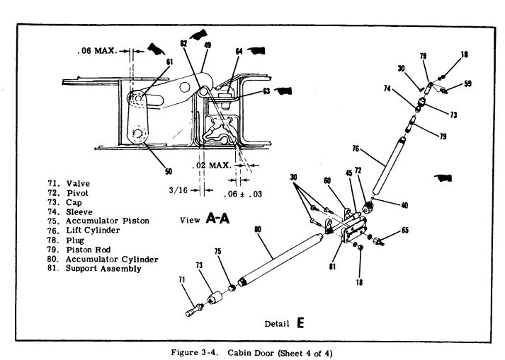

Join Date: Feb 2022
My service manual says to charge the cylinder 700 psi. But yes, it would be nice to see pictures. Must of been a later update.

Unread 03-17-23, 01:47 PM
Attachment 2887
No, its just my reading comprehension skills. I scanned it too fast and saw where they use shop air at the beginning of the procedure. I assumed that was to recharge the accumulator, but if you read further, you see that its not.
