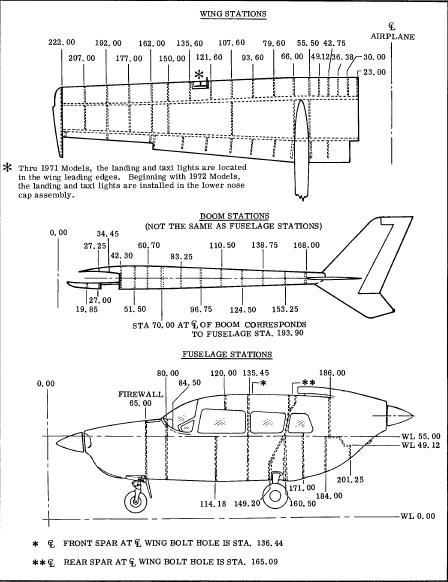

I don't know if it is practical for you to do so, but could you place a marker of some sort on the wing, coinciding with Station 177, and then take a picture.
It would help all of us to visualize where that is, in relation to the strut and it's attach point.

Tony
See attached diagram for wing station's.
