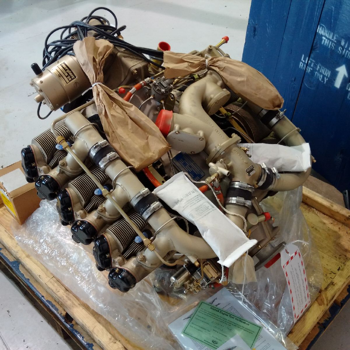

Unread 04-21-15, 10:46 AM
JamesC JamesC is offline
Join Date: Sep 2013
Location: Canada
Posts: 102
A thing of beauty has arrived...
  #26
Unread 04-21-15, 04:39 PM
Posts: 437
Awesome, very nice! )

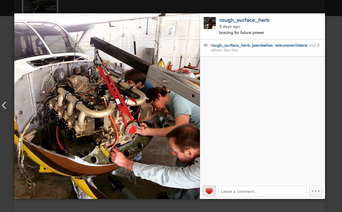

Unread 04-21-15, 09:13 PM
looks sweet James, mine is almost complete on the install. had to stop and head south for Sun N Fun but will finish when I get back in a week. No hurry just enjoying the build so far. It's amazing how much time it takes to prep everything. I pickup one part or component and I can't put back on until it's cleaned, degreased and painted. I took the lead from Continental and accented everything gloss black, so far it looks pretty good. Good luck on the project and if you have any problem with the Lord Mounts lining up with the block let me know
Name:	Screenshot 2015-04-21 21.15.22.png
  #28
Unread 04-21-15, 09:46 PM
Posts: 437
Looks great as well Herb. Looks like you have lots of helpers! Have fun!
  #29
Unread 05-16-15, 06:55 AM
Well we fired her up yesterday and everything went great. Flew it home last night and it did fine. Lotsa power, CHT stable, oil pres good and all vitals normal...........cheers
