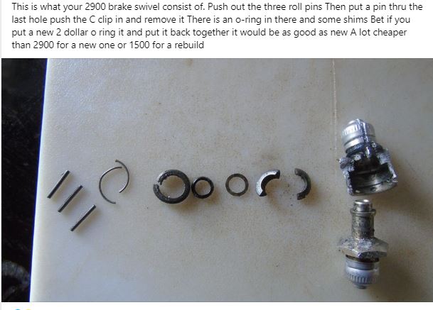

1 Attachment(s)
Attachment 2874Based on what some others have reported paying, you did pretty well at $300.
Like you, I also have a electro-mechanical background, and usually have success "figuring it out as I go", but without an explosion diagram or similar, that swivel fitting is a tough nut to crack!
*I posted the photo from FB below so we will always have it here, even if the post is removed from FB for any reason.
wslade2 03-07-23 08:12 PM
Good idea posting the photo
Note, in the photo, snap ring is broken, therefore not available for reuse.

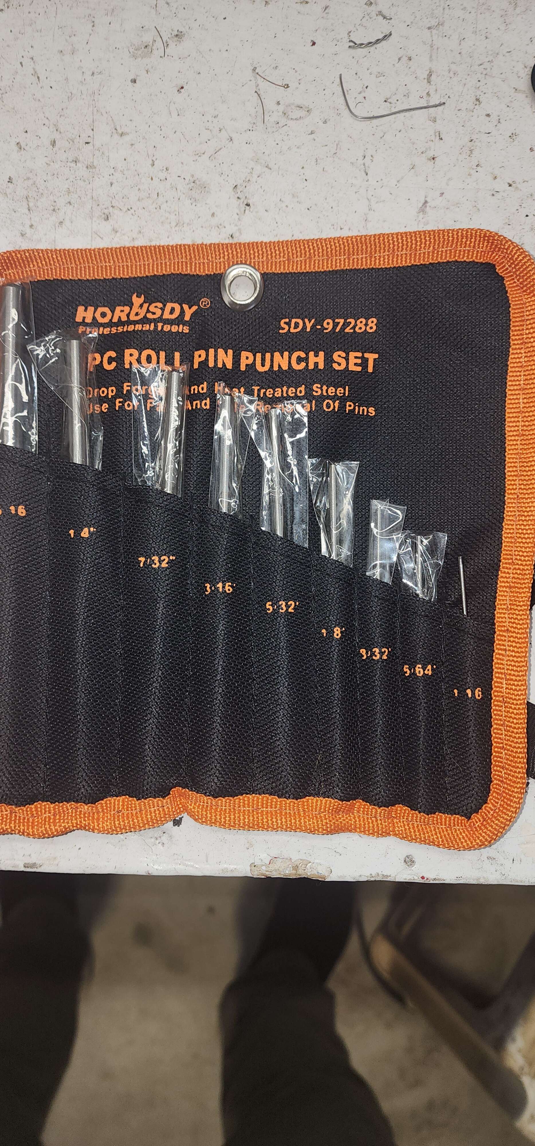

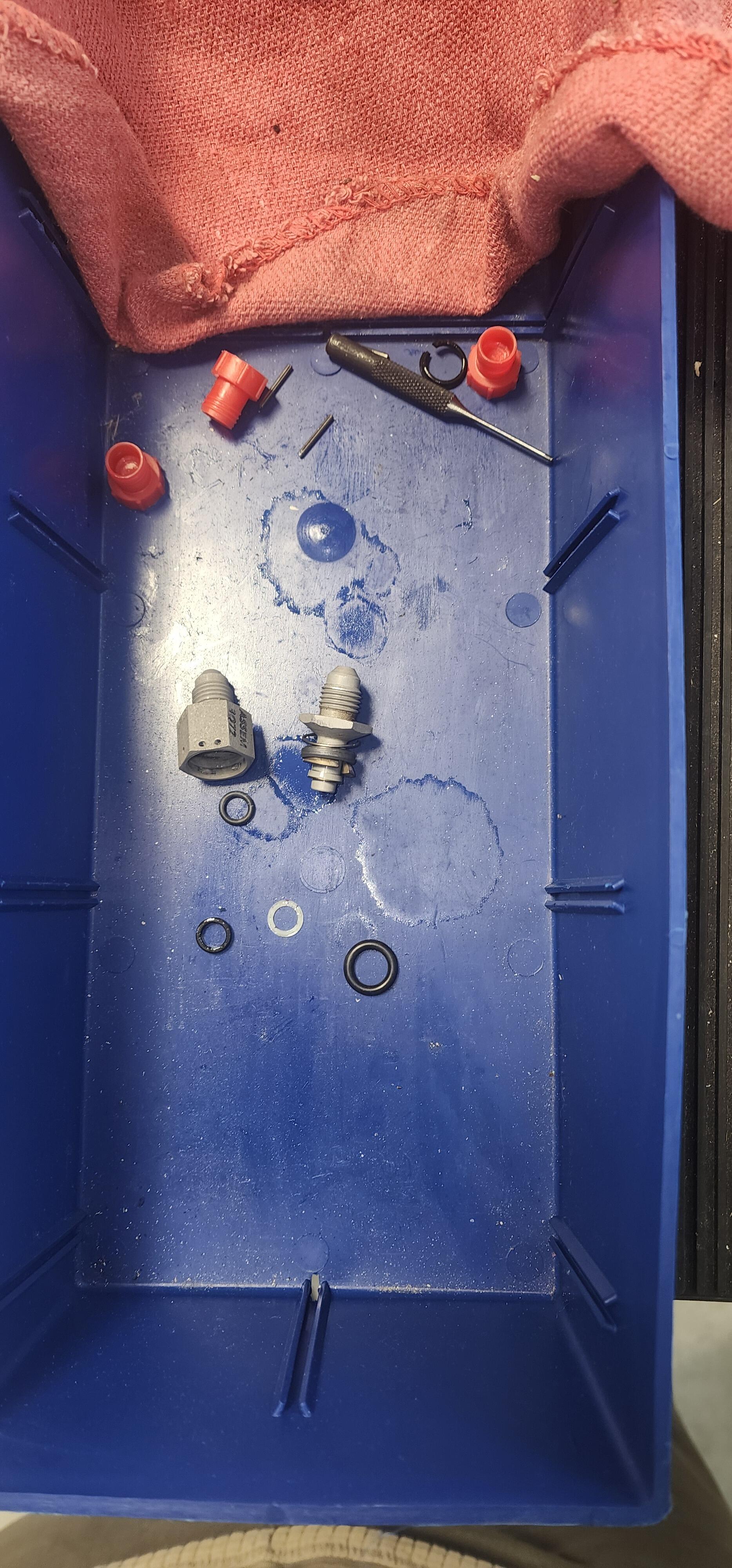

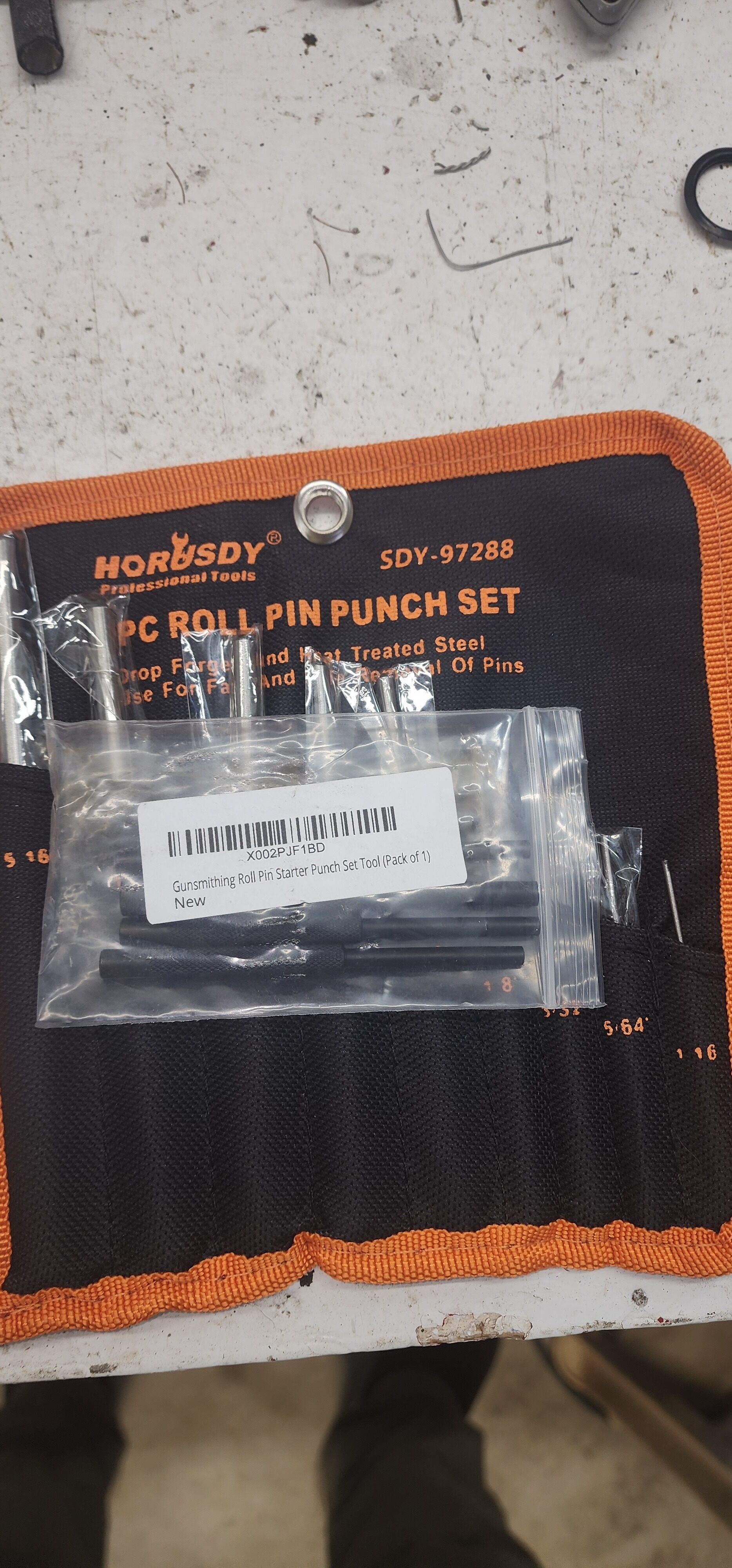

Rebuilt both swivels
3 Attachment(s)
Attached are some photos of swivel components and tools used in the rebuilding. Joes
Attachment 3015
Attachment 3016
Attachment 3017
Dan schultz 12-03-23 11:29 AM
I have two swivels out of my parts plane
mshac 12-03-23 05:12 PM
Looks like with the right parts and tools, you could rebuild one of these in under 15 minutes! :cool:
