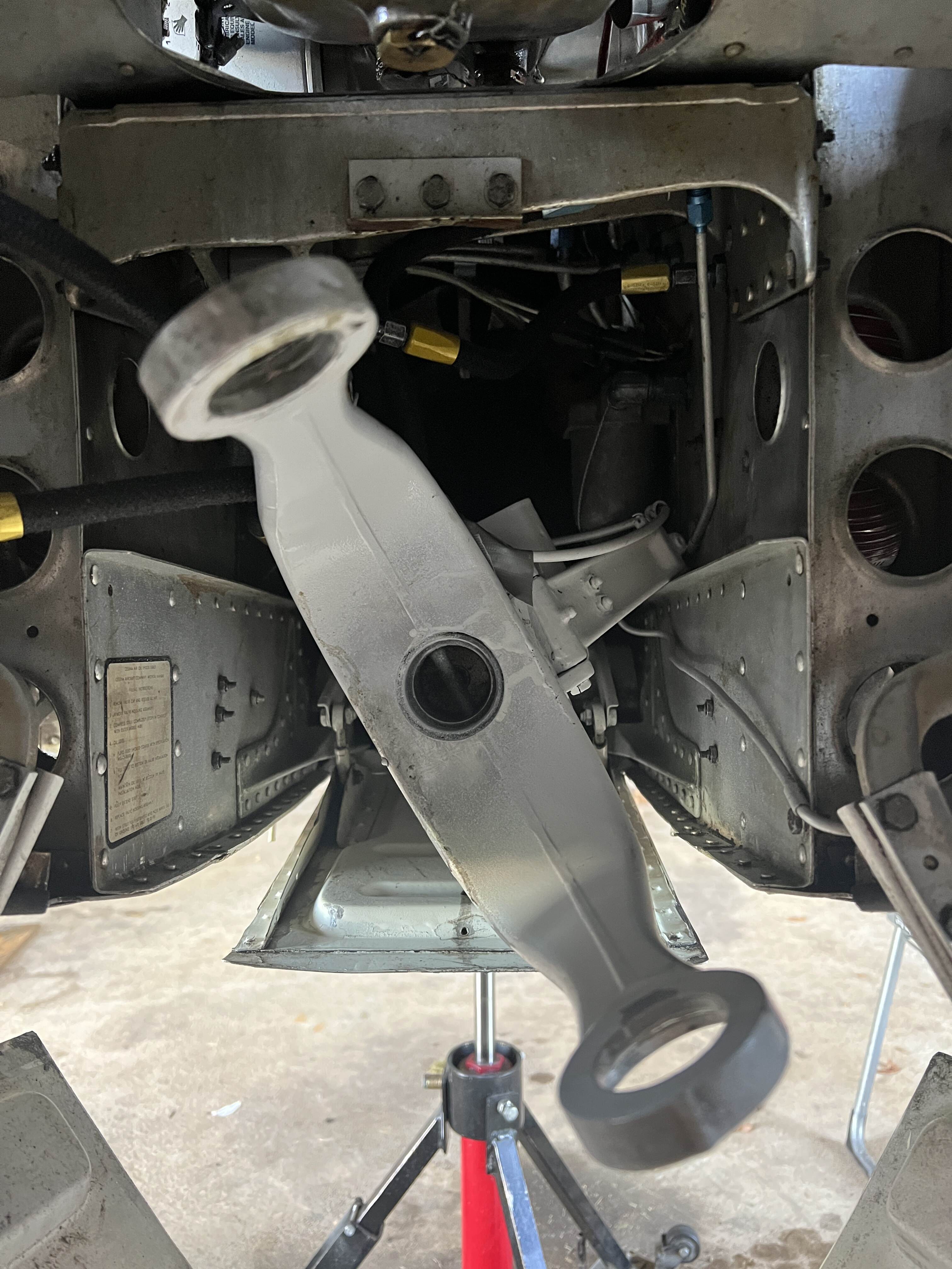

In this photo, you can see what happens when the nose gear is not fully extended. It
jams on right side scissor not allowing the wheel to fully seat.
Attachment 2716
