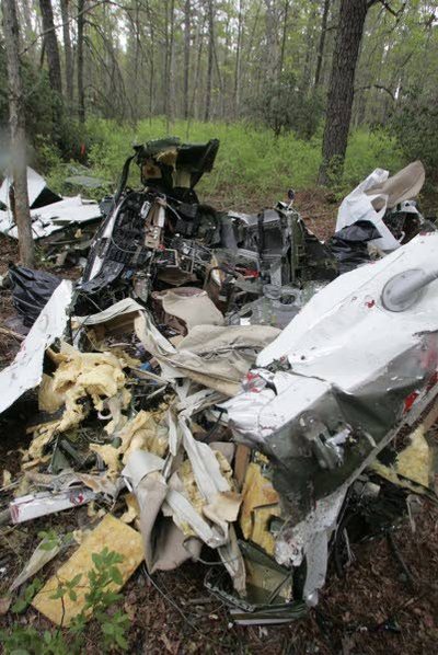

Quite an amazing story on this crash. Try the links above

Sounds like fuel starvation to me.
Unread 05-31-08, 09:10 PM
That's the first thing I thought of too. Could have been contamination also. What a shame, and just really strange sequence of events.
