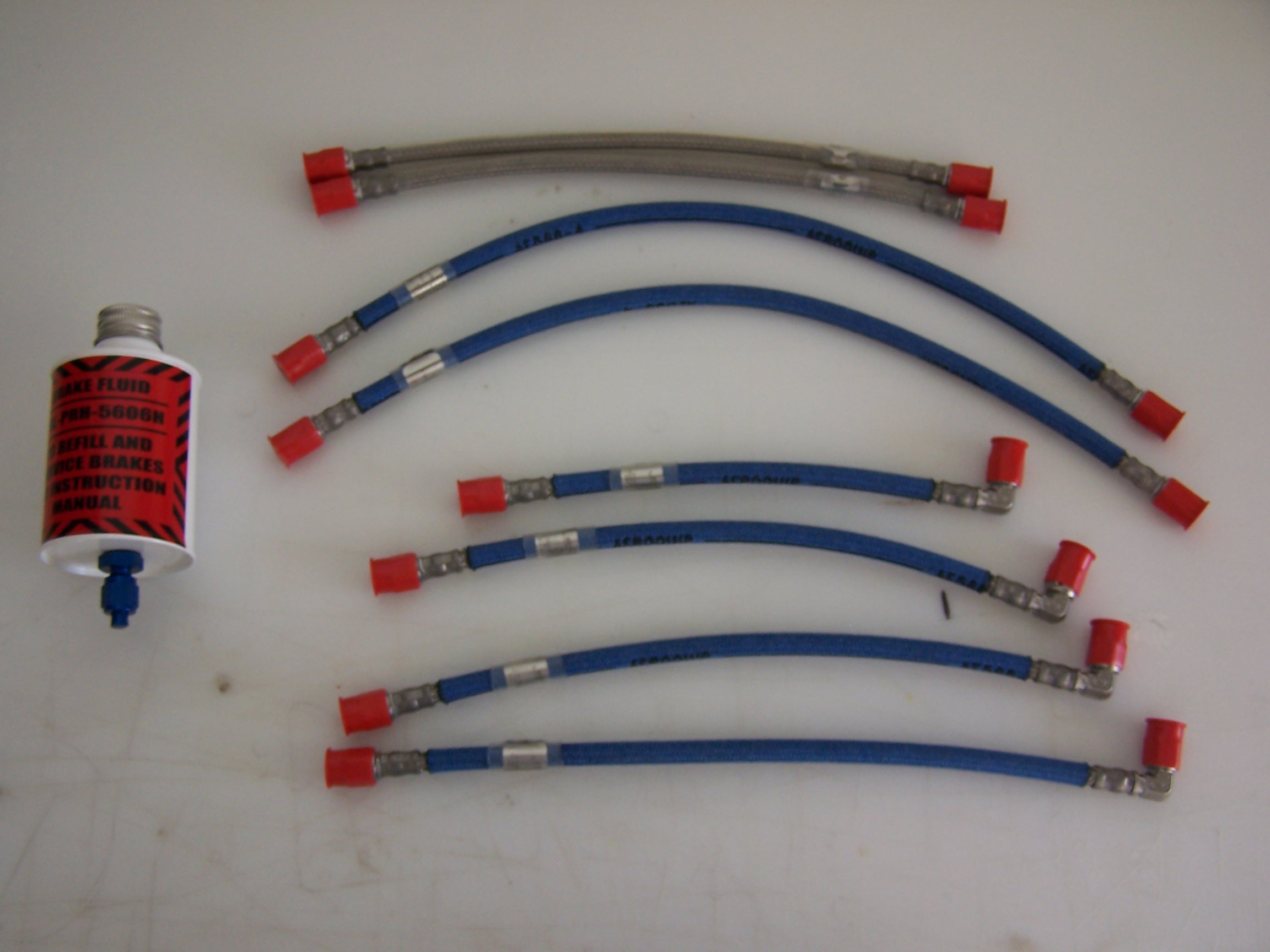

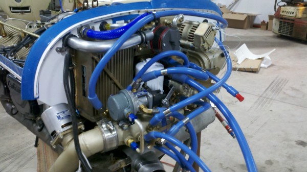

I can do your teflon hoses in various colors
all with tso and certs
Colors:
Marron
Brown
Med Blue
all with s/s fittings
I will be doing a black firesleeve next ( slip ) on type with teflon hoses underneth for a stc holder that requires black hoses with hose black baffles and seals
