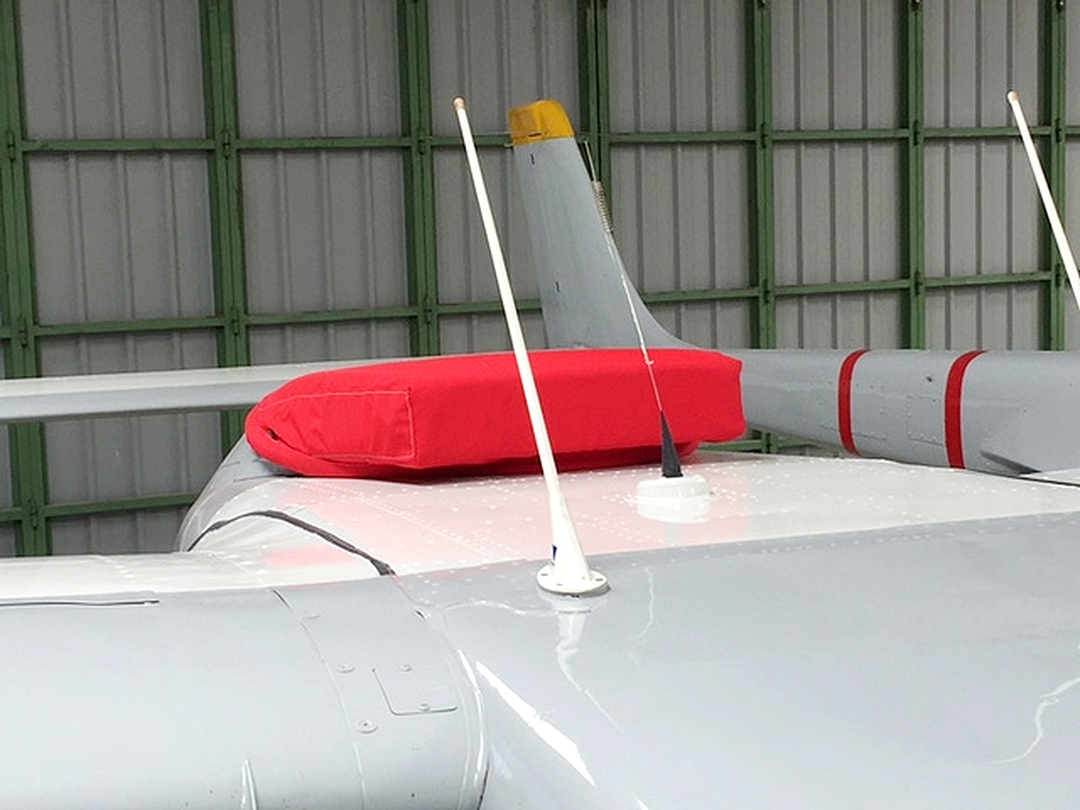

I think I am going to figure out a makeshift plug for top scoop to eliminate water coming into compartment that direction, and see if that helps any....
https://www.aircraftcovers.com/337#15

I think I may try the following experiment:
- soak the plane through that top scoop at a washing bay, then see if the engine displays the problems.
- assuming it does (which reinforces my theory), then put some sort of cover over the scoop (yes I saw link for the $150 cover, but think I may be able to ddo something more along the lines of a camping style rain fly that is much more lightweight to carry around)
- the try to resoak and repeat test
