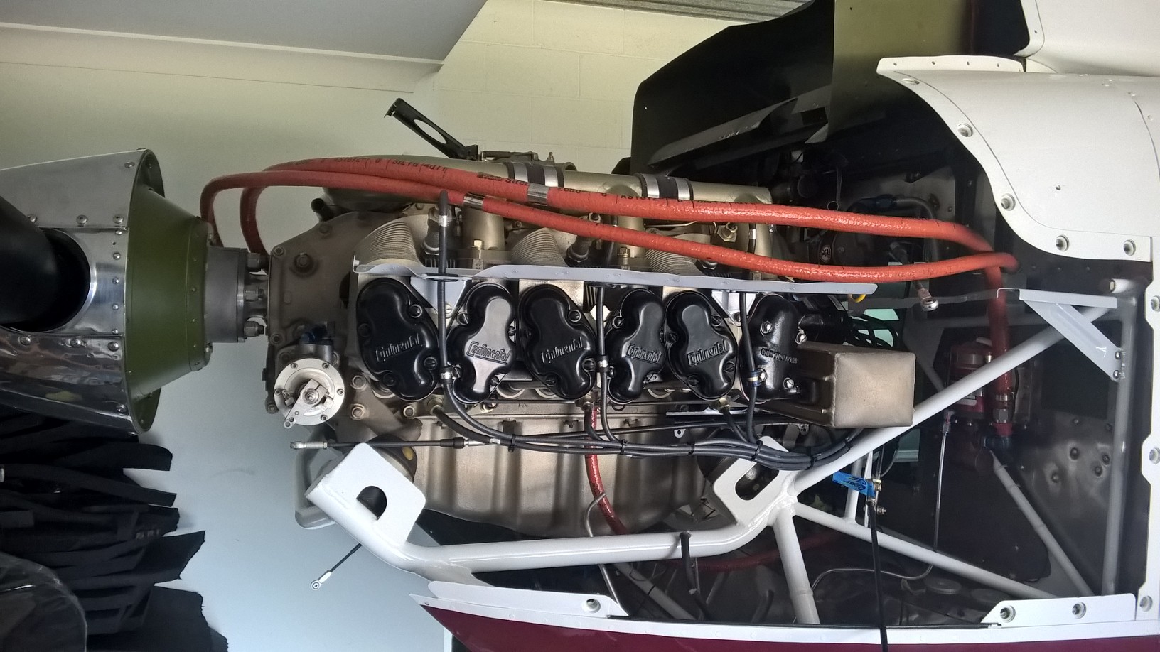

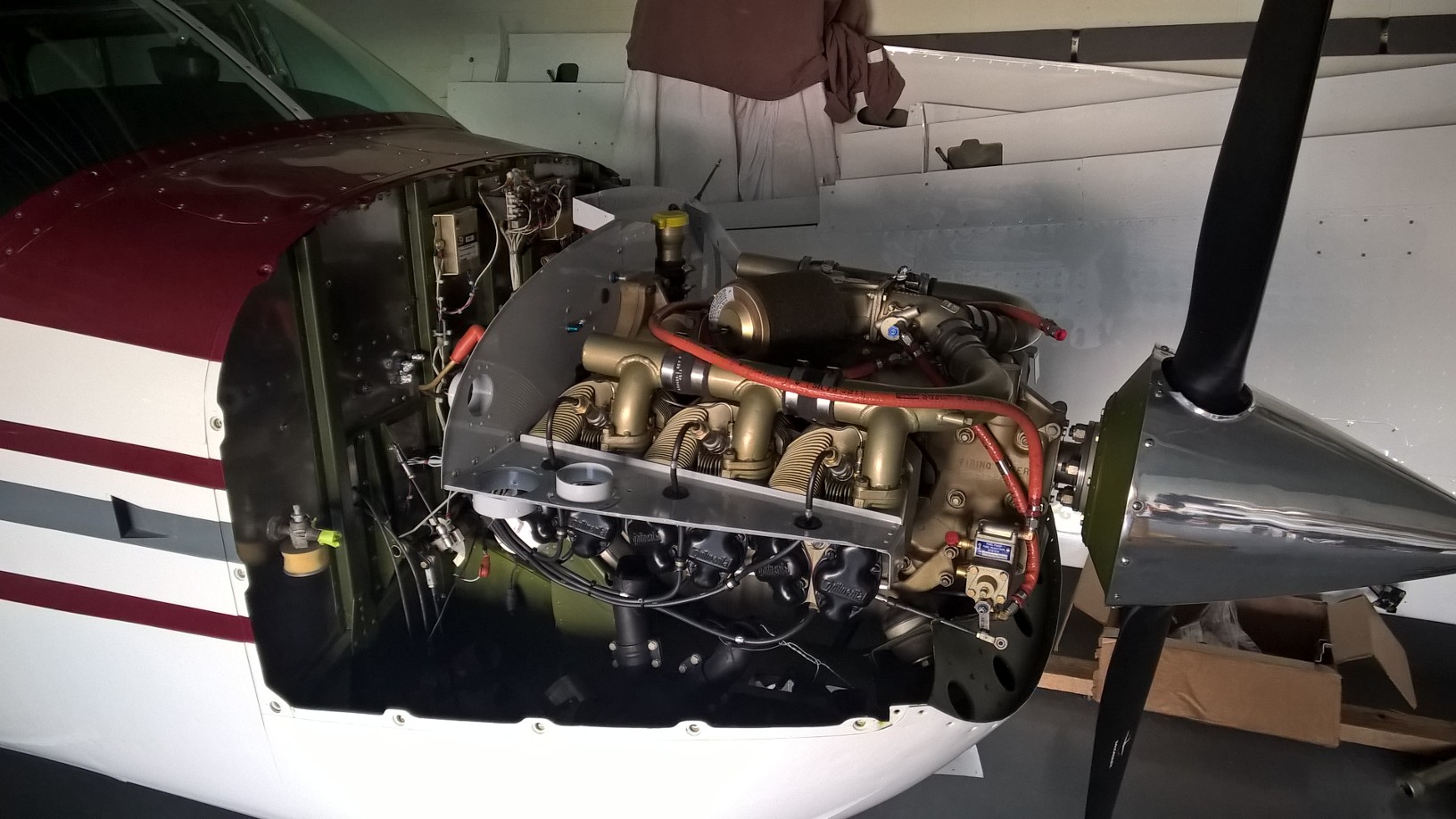

So a couple of photo's of the engines installed this week.
Aircraft details
Reg:VH-DMS
1974G SN337-1575
Airframe TT 1953hrs
FE IO- 360G 553 SFRM - Calender 12 years to go (Just been bulk stripped and freshened up, rings, bearing etc)
FP 227 S O/H - Including Gov
RE IO-360GB1B 589 SFRM - Calender 8 years to go
RP 227 s O/H - Including Gov
Everything else is new.

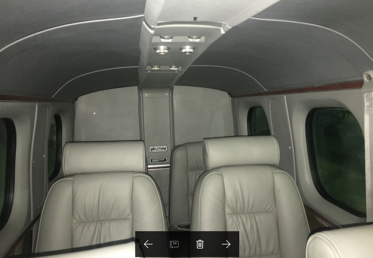

Well a busy few weeks, lots of evenings and big weekends since getting back into Aus finishing the old bus.
Interior back in, W&B done, just waiting for the CoA, avionics sign off, then off we go.

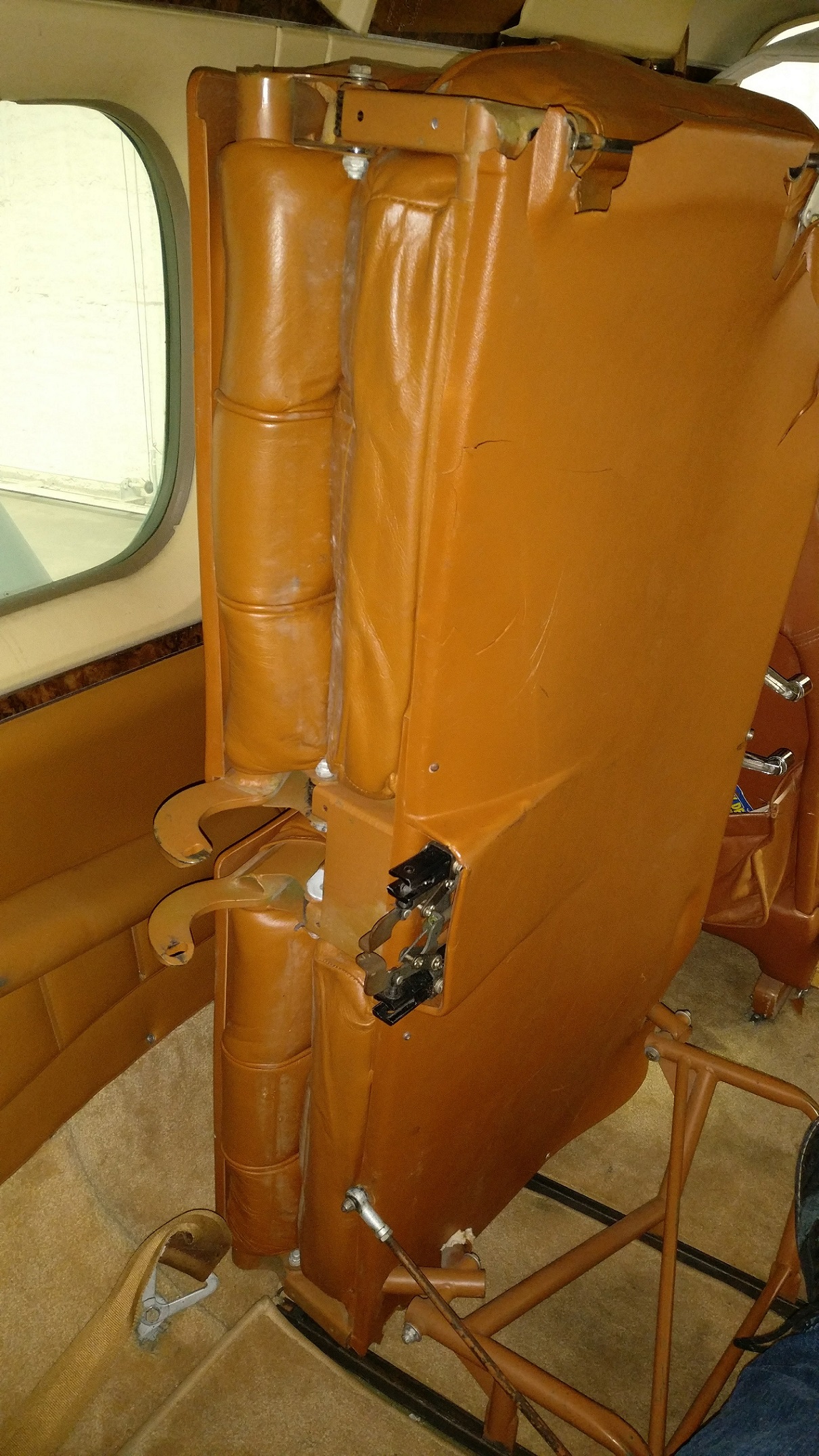

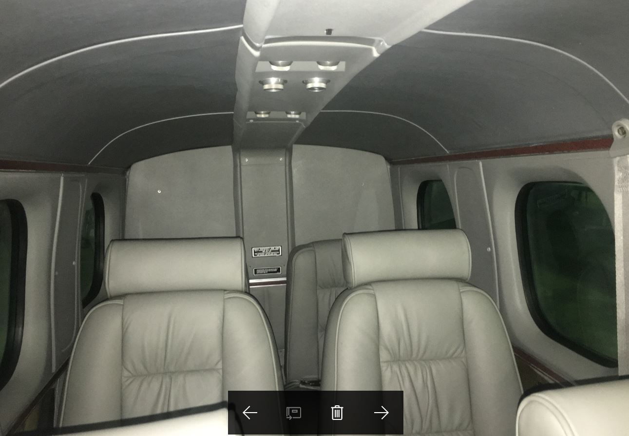

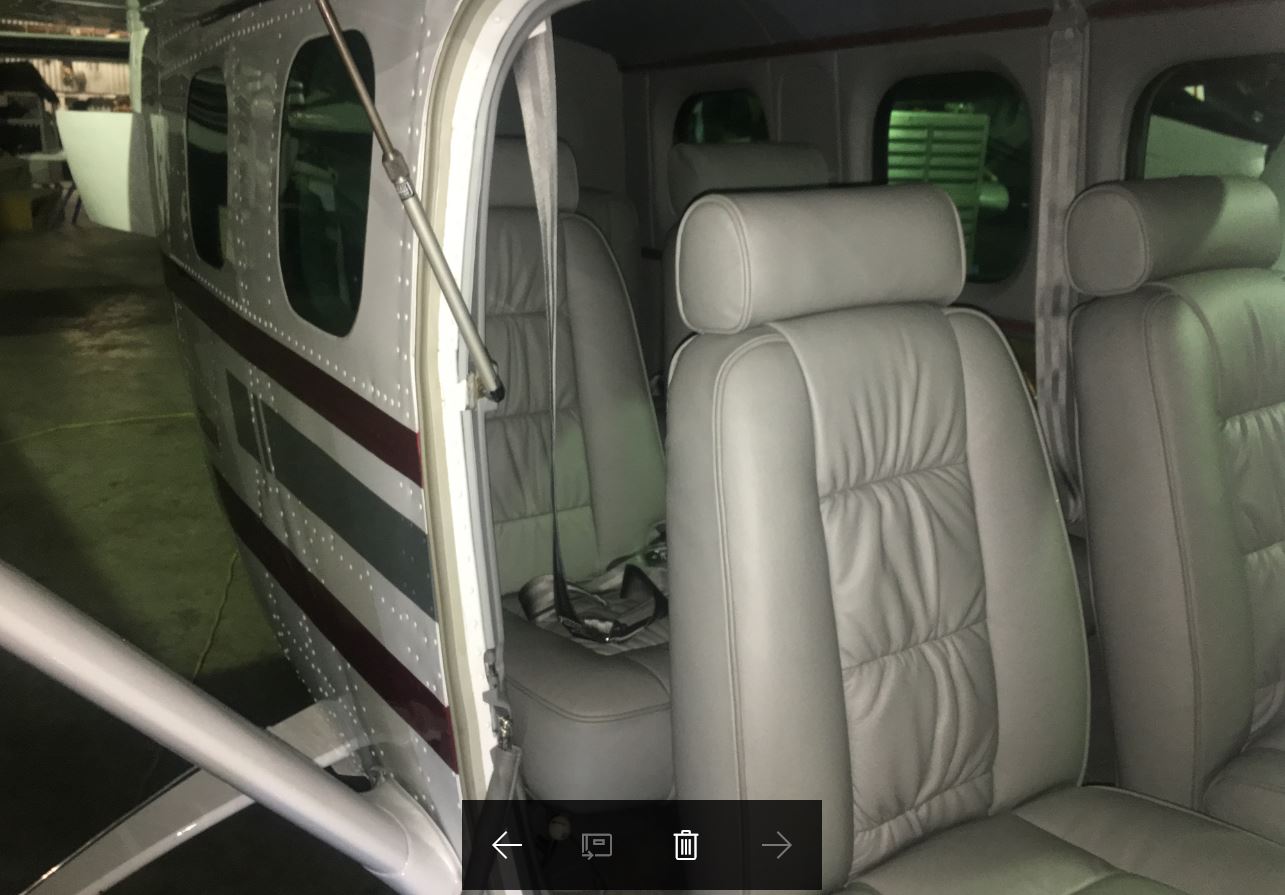

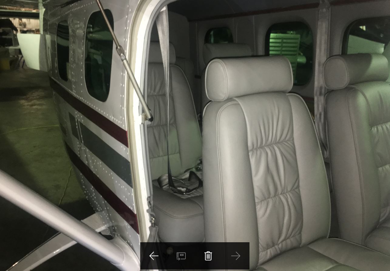

I have a question and an ask, I need help from those having 74G. They are related to the middle seat (been 7 years since it was disassembled) and the manual is just not that specific.
First question: When you move the white knob located on the front lower right of the seat base which releases the back rest's, do they spring forward by themselves?
The ask : Middle seatbelt locations, I am not happy with the location, could I get a photo of the belt mounting on another 74G for the middle seat.
Some photo's of the interior......
Yes they do...I've attached a picture of mine a couple weeks ago prior to interior removal. Not great pic, but....
Send me your email address and I'll send you a link to my album of interior pics prior to taking it apart.
