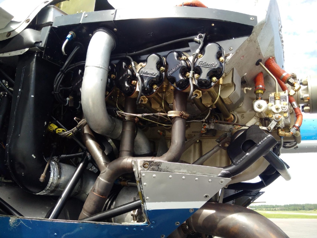

Unread 07-09-15, 01:15 PM
JamesC JamesC is offline
Join Date: Sep 2013
Location: Canada
Posts: 102
Mine is a 1979 so is different but still there are no angles into the turbo inlet only curves.
Unrelated you will notice a crimped off line in the top left - goes off the upper deck to the pressurized mag - received the inline filter so line is about to be re-connected.

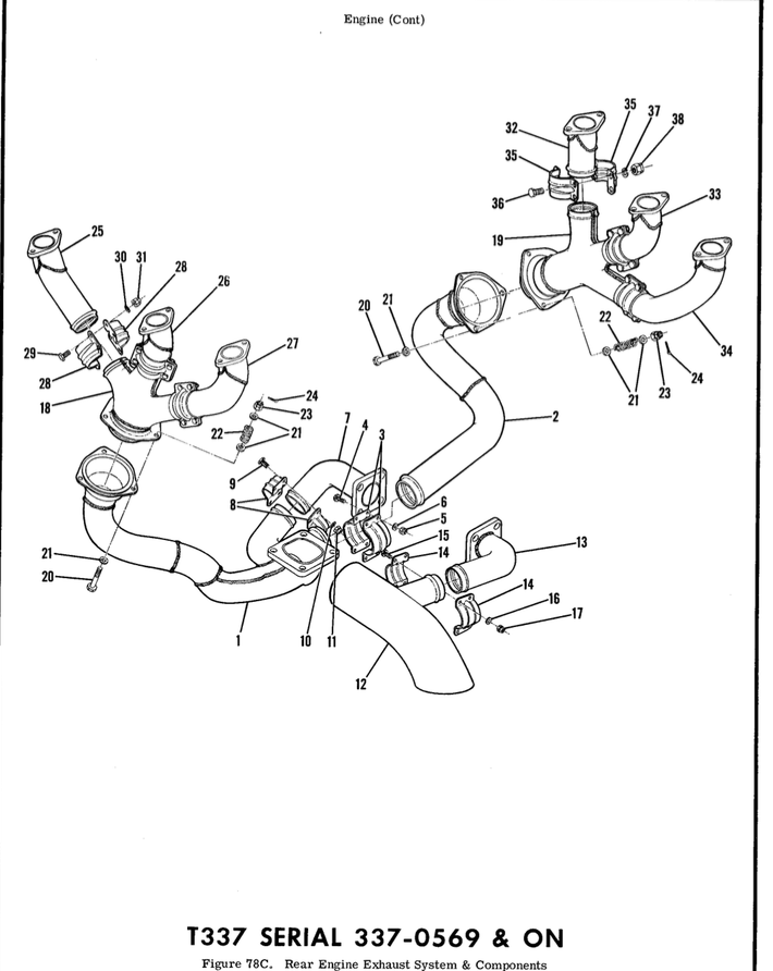

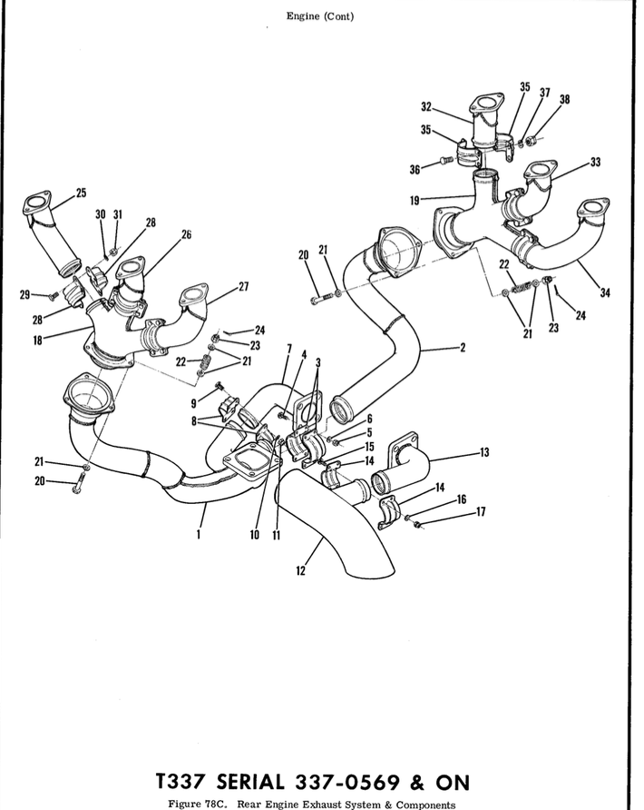

Unread 07-09-15, 03:28 PM
from the parts manual
Name:	Screenshot 2015-07-09 15.26.41.png
