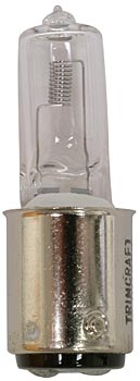

I am out on the field at SNF, so nowhere near my IPC. Does anyone have the part number handy for the rotating beacon bulb of a T337C?

Do you have a rotating beacon, or a flashing beacon?

As far as I know it was a flashing bulb. Doesn't seem to rotate at all. When I took the lens cover off to check the bulb, it was gone. Apparently it was removed by the previous owner when they installed the mammoth strobe on the belly.

TC 28V150W
Flashing Beacon Bulb 28 volt, Quartz Halogen, Trimcraft Aviation
Replaces Aeroflash 40-0003 or Cessna C17312-1 (24V)
If you are at Sun N Fun, they should have them at the Aircraft Spruce booth, for around $15
