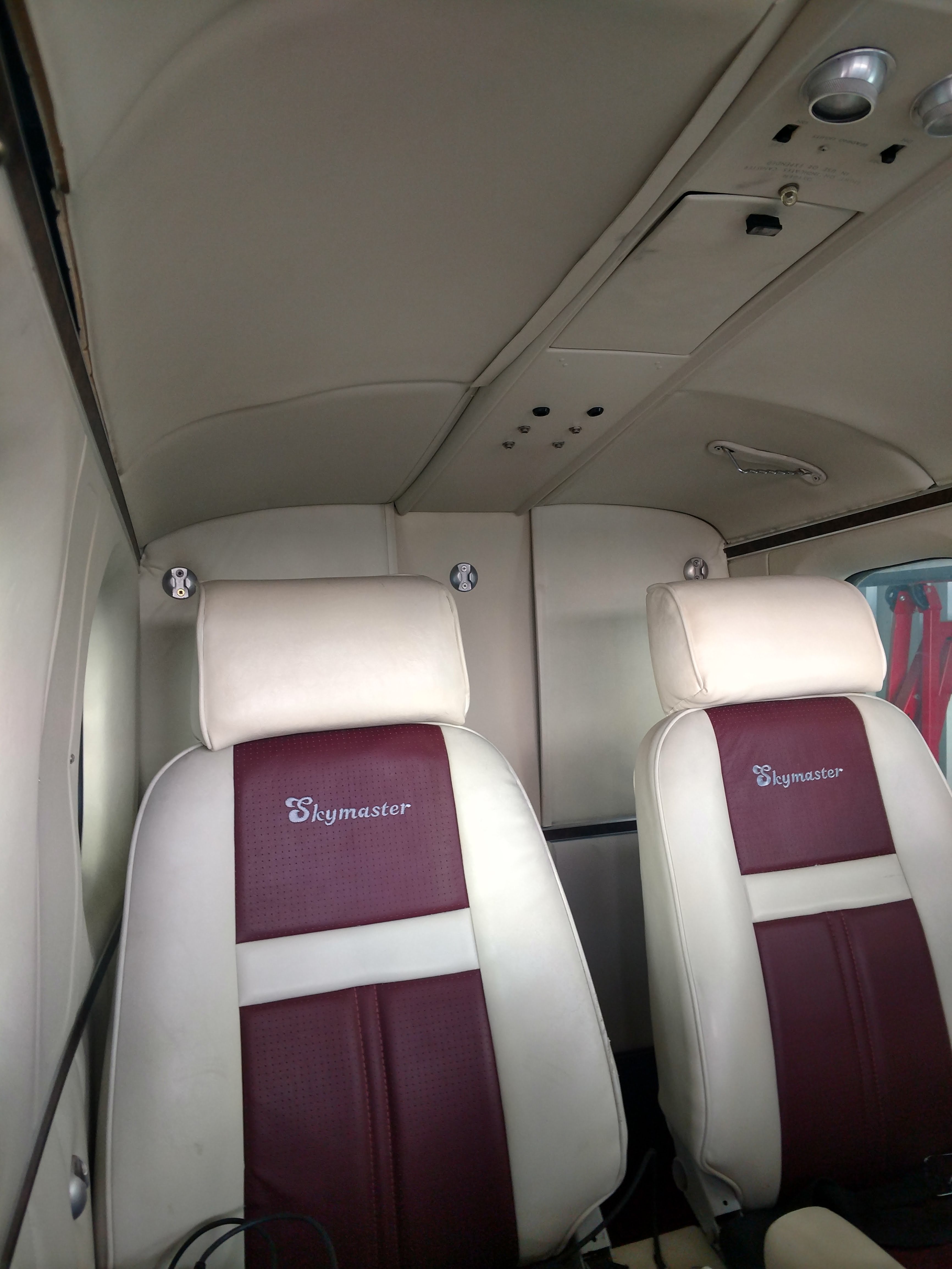

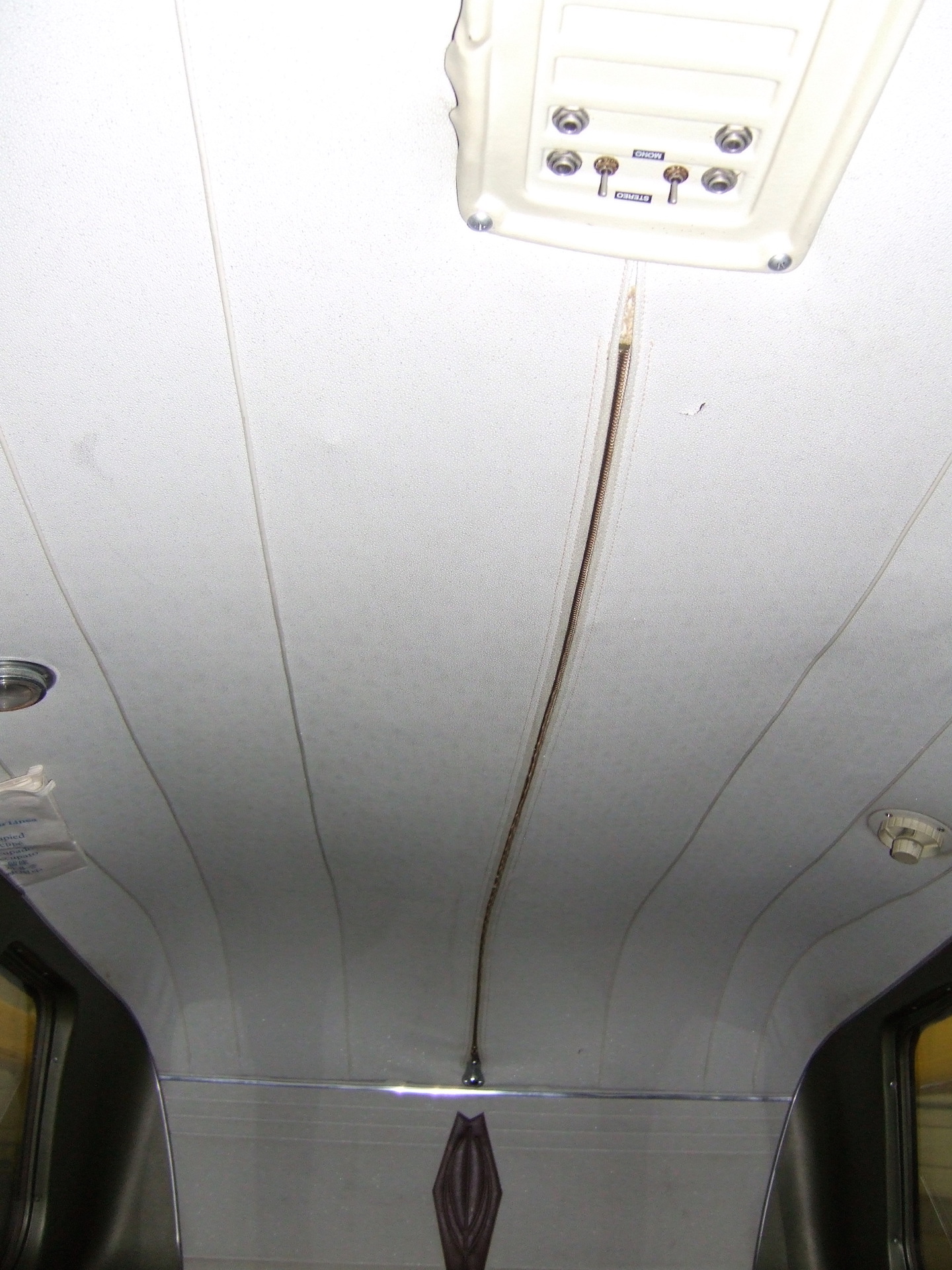

My jacks are in center ceiling. My 337 is pressurized so the O2 generators and breakers are in the center as well, still fits well.
File Type: jpeg AEB45E67-BEDB-419C-8EEE-0957FA3A2C9F.jpeg (955.1 KB, 2594 views)

Thanks much for the picture! I like that interior!
My headliner is more like Herb's with the overhead council ending and a zipper in the headliner from that point back. So where yours are located I just have a zipper. I looked at some pictures of the headliner and there is a little room left between the O2 controls and the end of the surrounding trim, but I have no idea of what it looks like there with the O2 system.
I am liking and leaning towards either the side wall or arm rests.

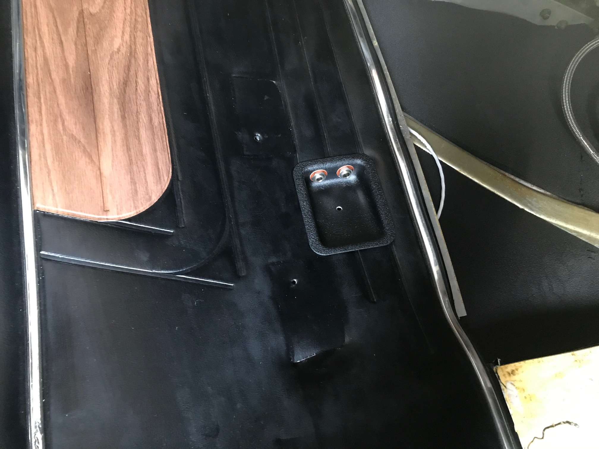

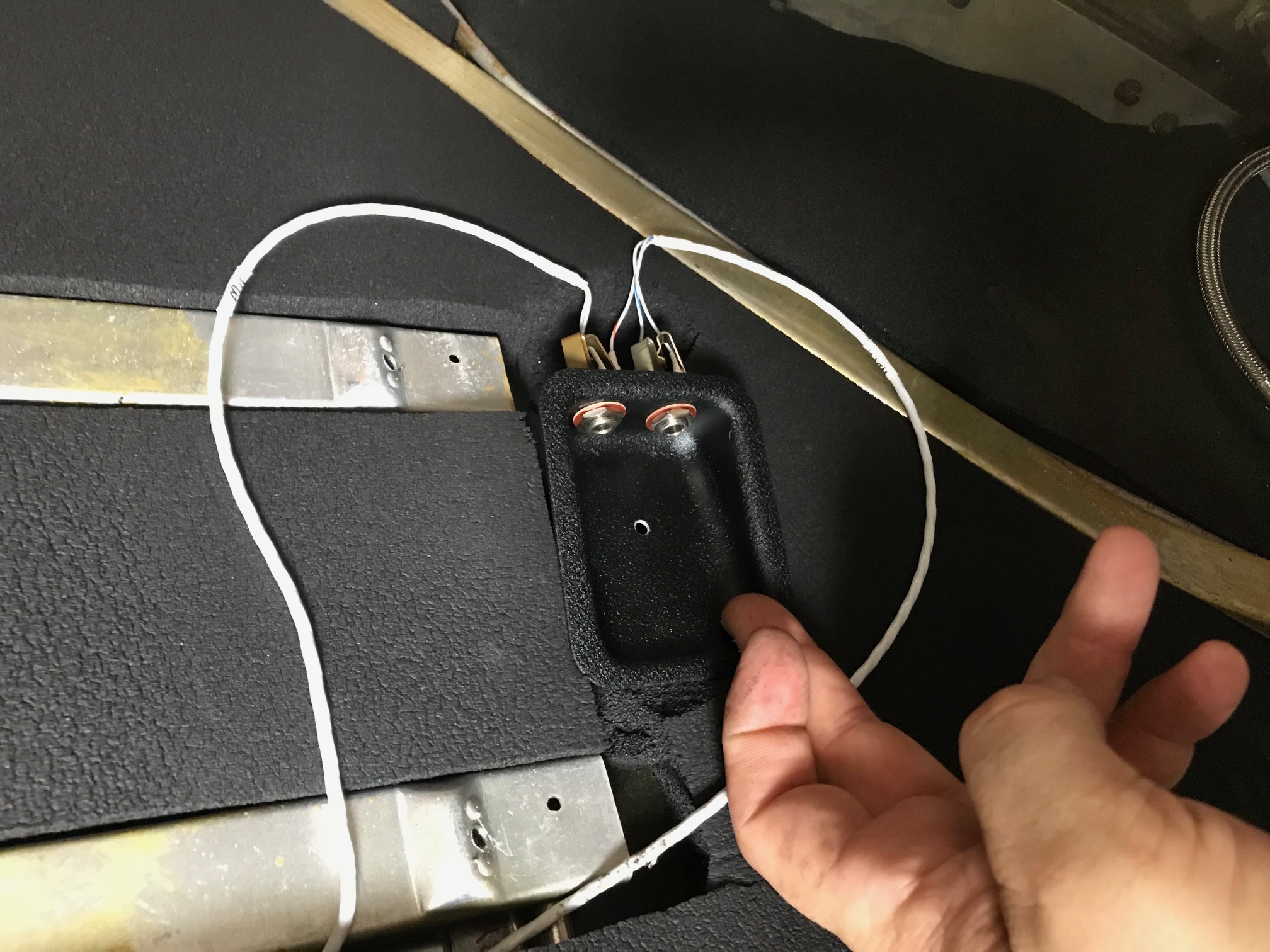

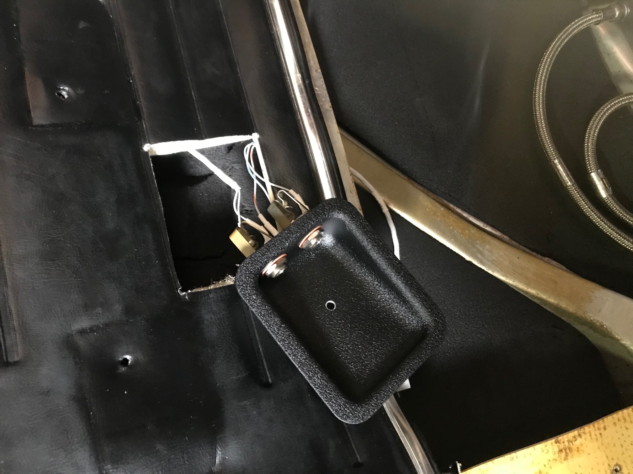

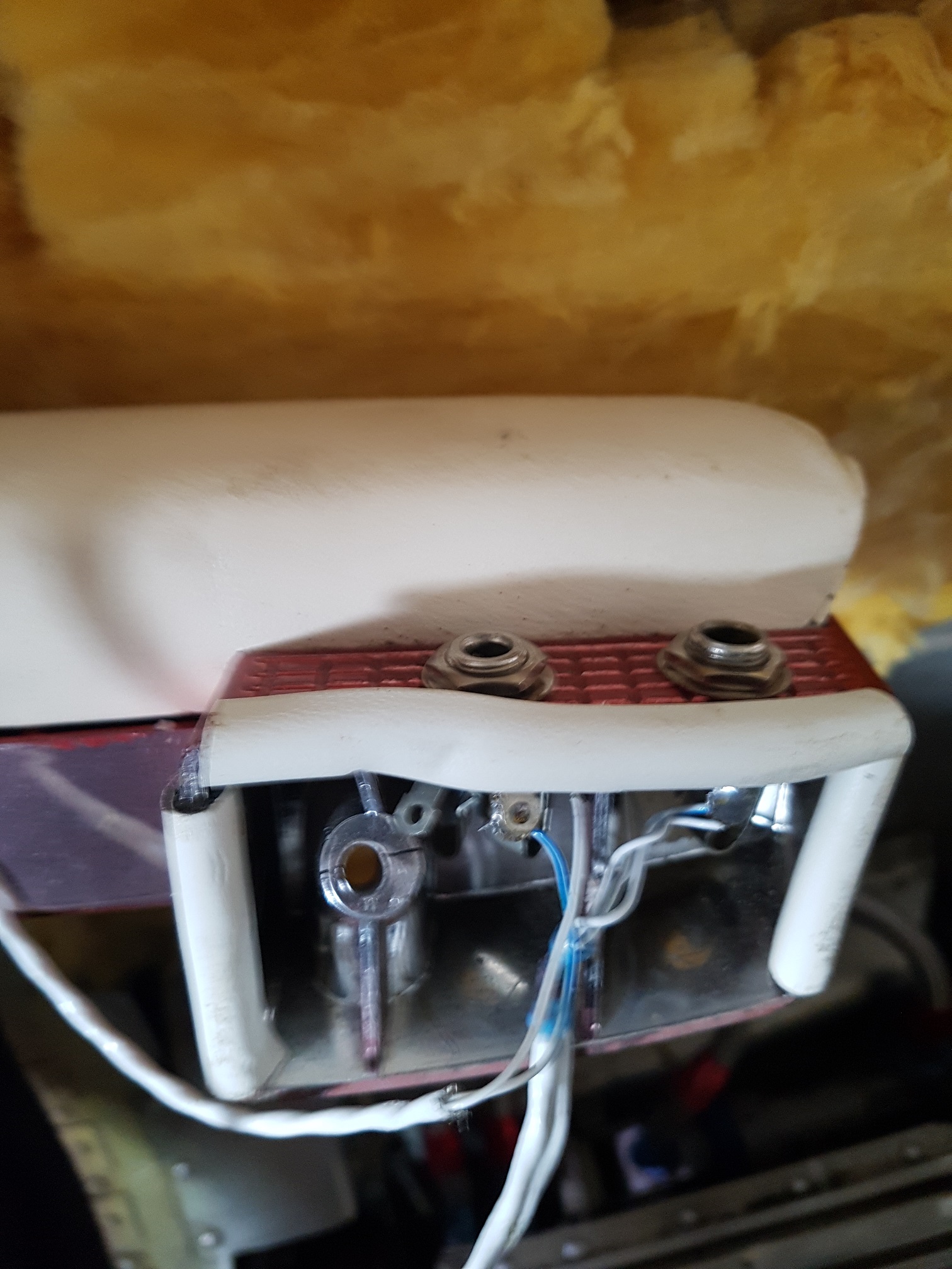

Here is a few pictures of my installation I am currently completing on the middle row jacks. I am installing them just under the arm rests - seemed to be best location for when seated and will not interfere with passenger, seat or egress. For the last row, I mounted on the bulkhead - lower portion, just above the vent to the outside. That one is not recessed. The mounts I purchased from Aircraft Spruce.
Regards,

Thanks Jeff, I think that is exactly what I am going to go with. The pictures really help out, much appreciated!!

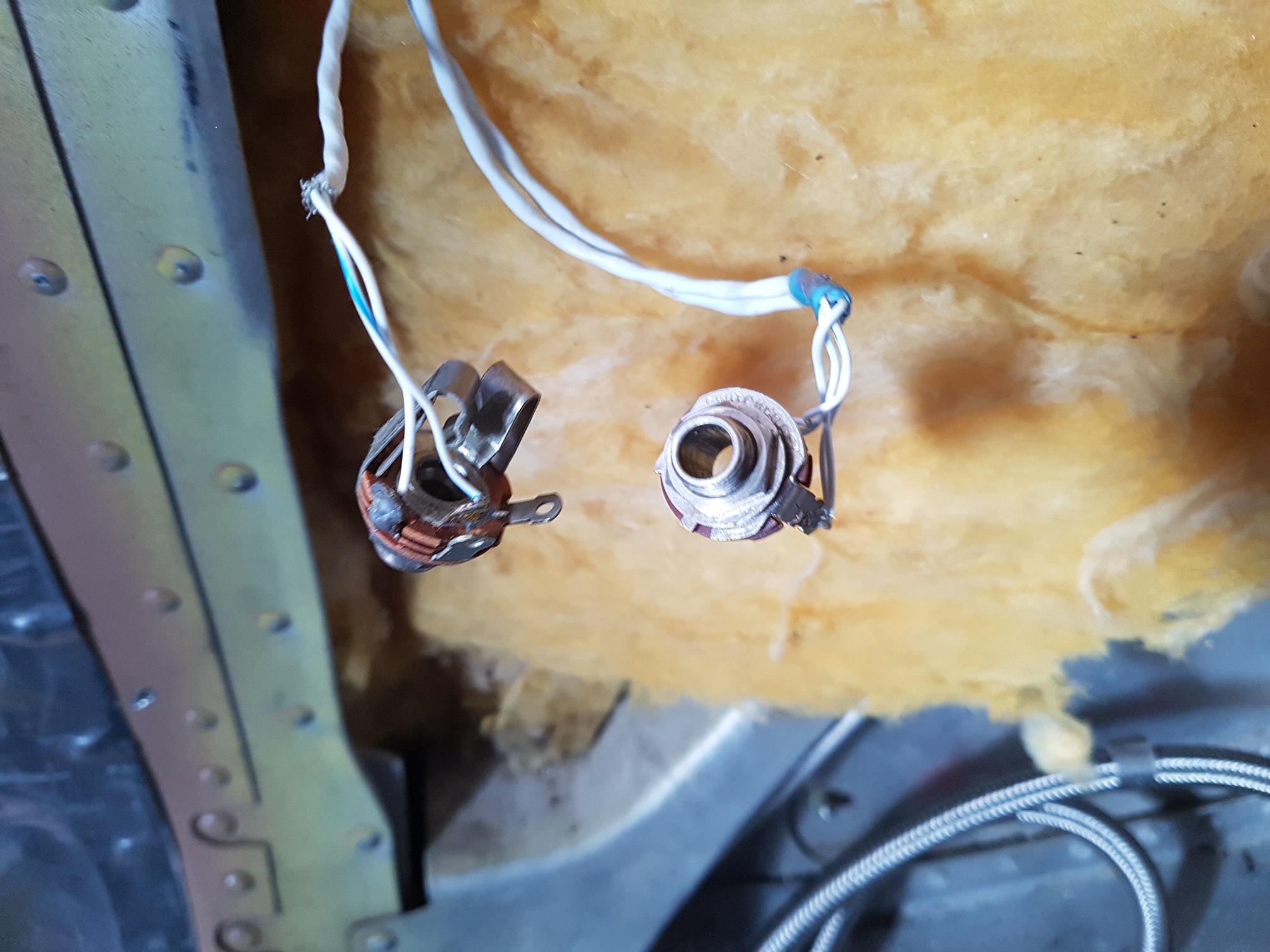

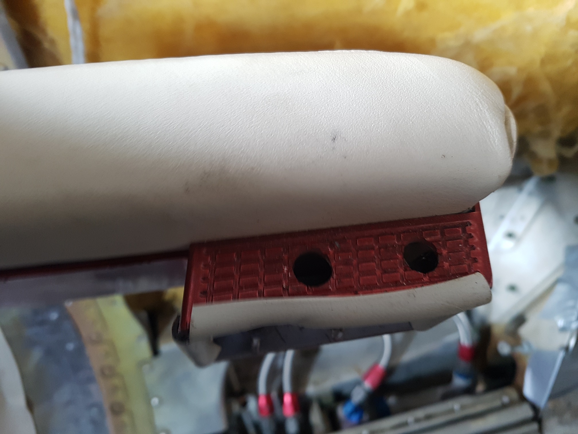

Here are the pictures of my jacks in the armrests
It will only let me post three pictures I posted all the pictures on the skymaster Facebook page
https://www.facebook.com/groups/28721444559/?fref=nf
Frank
