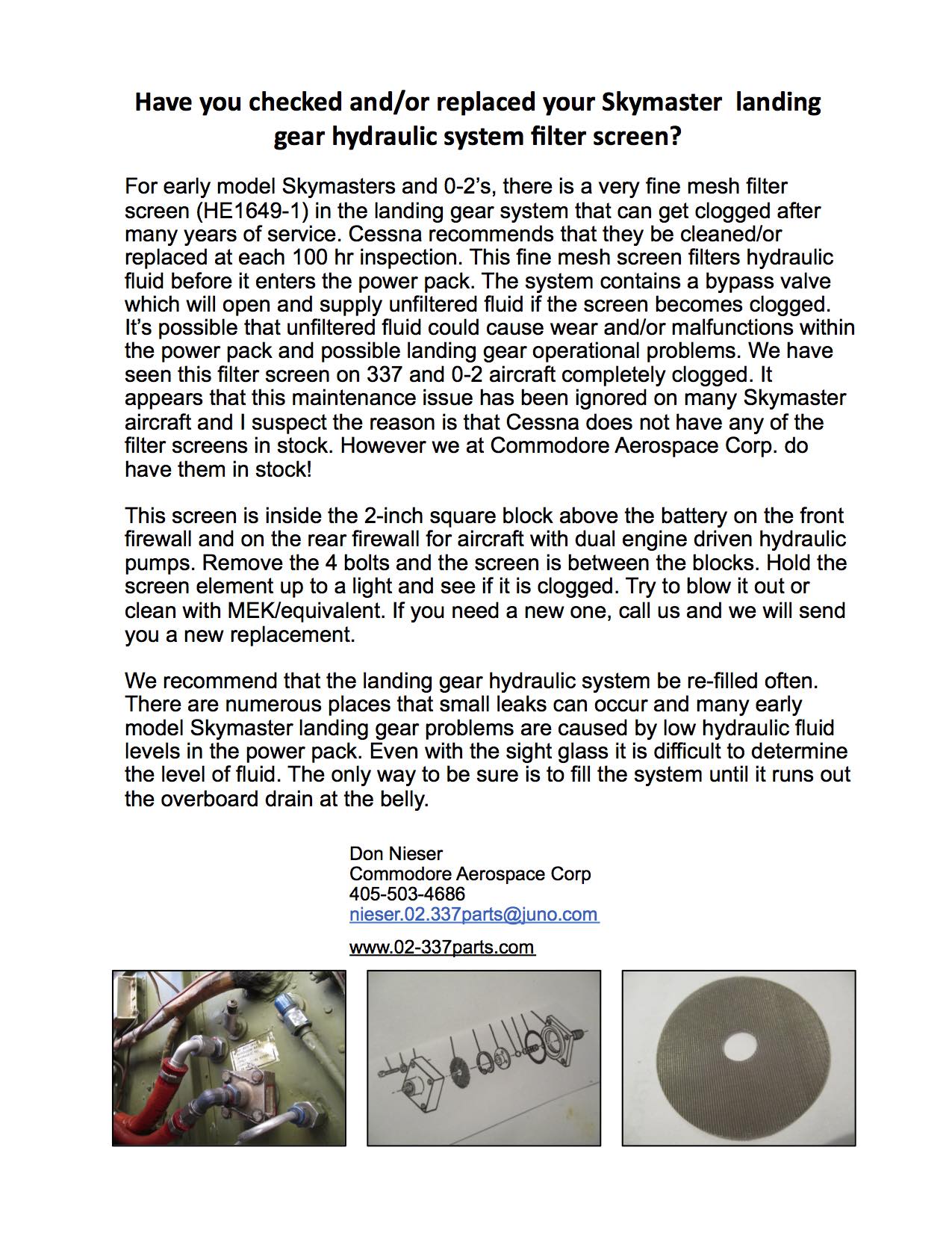

Unread 04-14-20, 04:20 PM
Tip number 2 from Don Nieser
Attachment below
Have you checked and/or replaced your Skymaster landing gear hydraulic system filter screen?
File Type: jpg Updated Hydraulic Filter Screen.pptx.jpg (315.8 KB, 10918 views)
