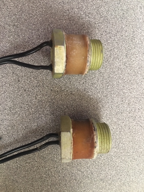

Can you post a picture of this pickup? I might have an extra.

Is this what you are looking for?

Pick-up
Kevin (kbecker),
If Ohio does not take you up on the offer for the tach pick-up, I will. I just troubleshot my rear tach and determined it is the pick-up. I have found a source for a new one, but if I can get a better price on a used one I would prefer that. I have an Insight G4T with electronic tach which is far more accurate, however, it is not legal to replace the old Cessna primary.
