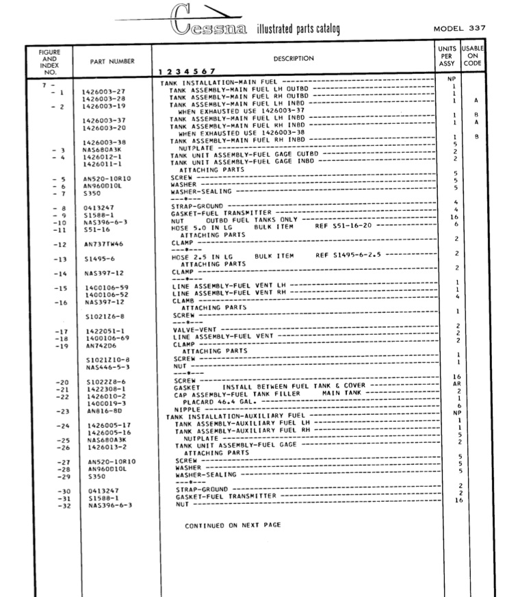

I think you want an S350, which is a standard/stock aerospace part (see figure below).

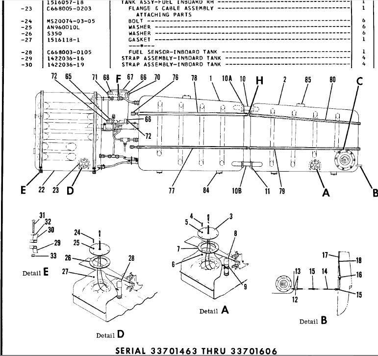

Guess it depends on the model. Here is from my PC
Part #31

Yes, Ed, it does depend on the model. Since I know yours is a '73, the picture in my message is from the parts manual for a '73.

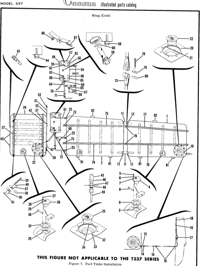

I looked for the gasket in the fuel selector valve in the wing. You can see the gasket in the illustration, but there is no part number, so it must not be available separately. Notice that some of the other parts come only in an Airborne kit.

So, does anyone know the part number for gasket in the fuel selector valve in the wing?
The number is listed in the O-2 Illustrated Parts Manual, it is B3-12-1. I looks like it has six screw holes plus the large hole in the center.
