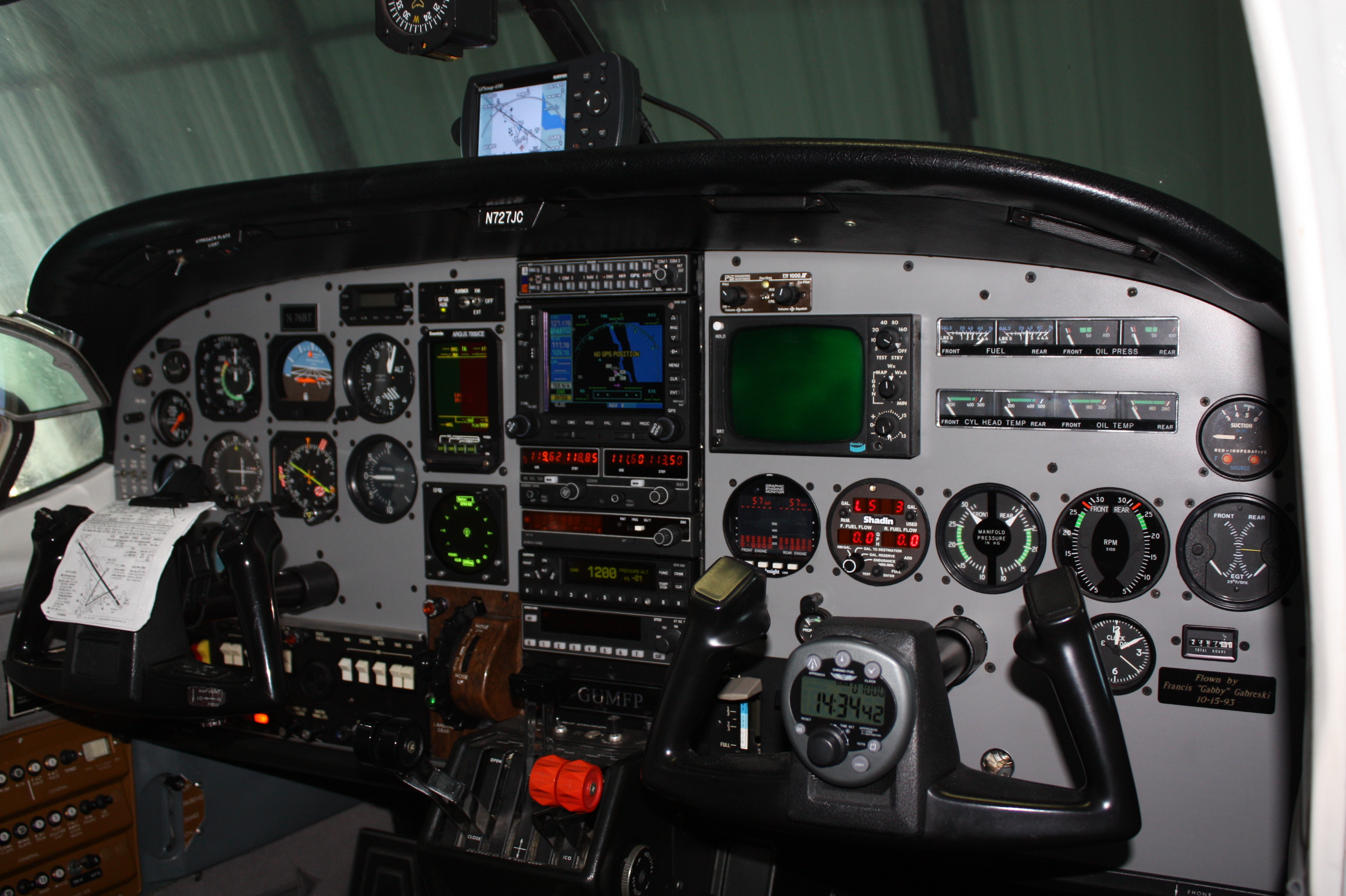

Here's a pic of my metal panel

Nice panel. Question, how do you like the Insight Engine Monitor? Compared to JPI? I notice you also have the Shadin Fuel Flow, what is the advatage to the Shadin vs JPI with fuel flow transducers and coupled to the 530? Do you need both? You have removed the original fuel flow by having the Shadin. Can the JPI with fuel also allow the removal of original fuel flow?

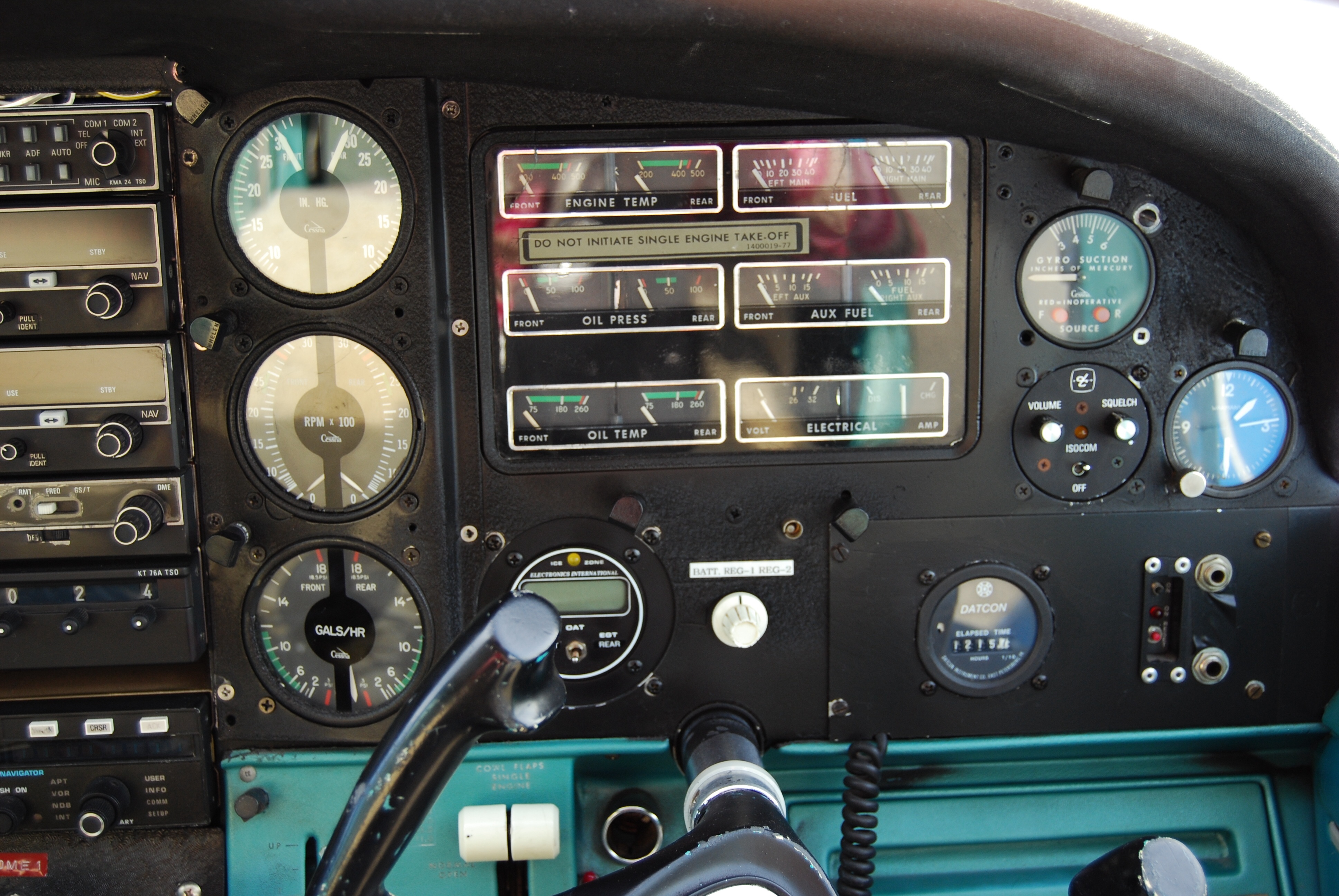

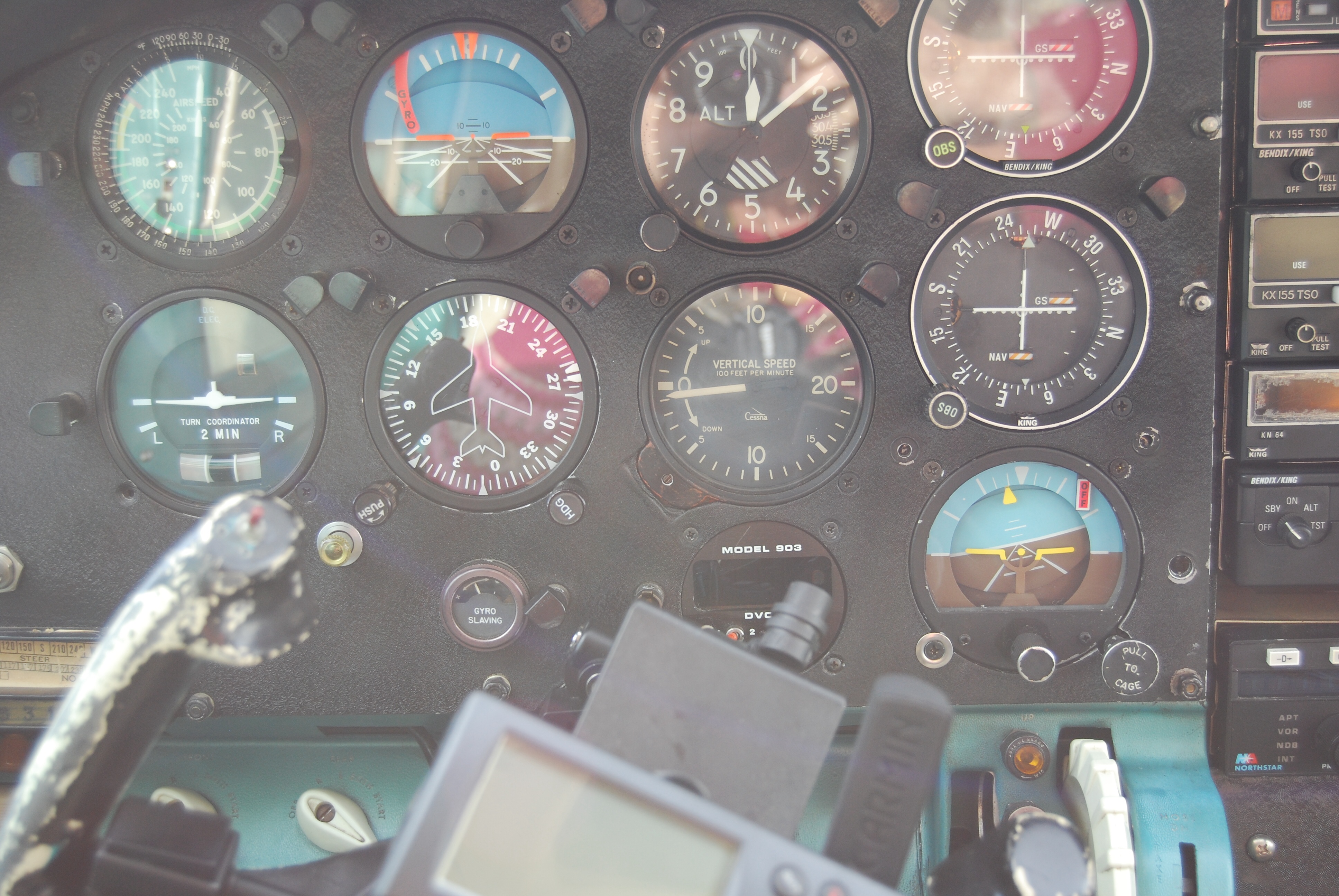

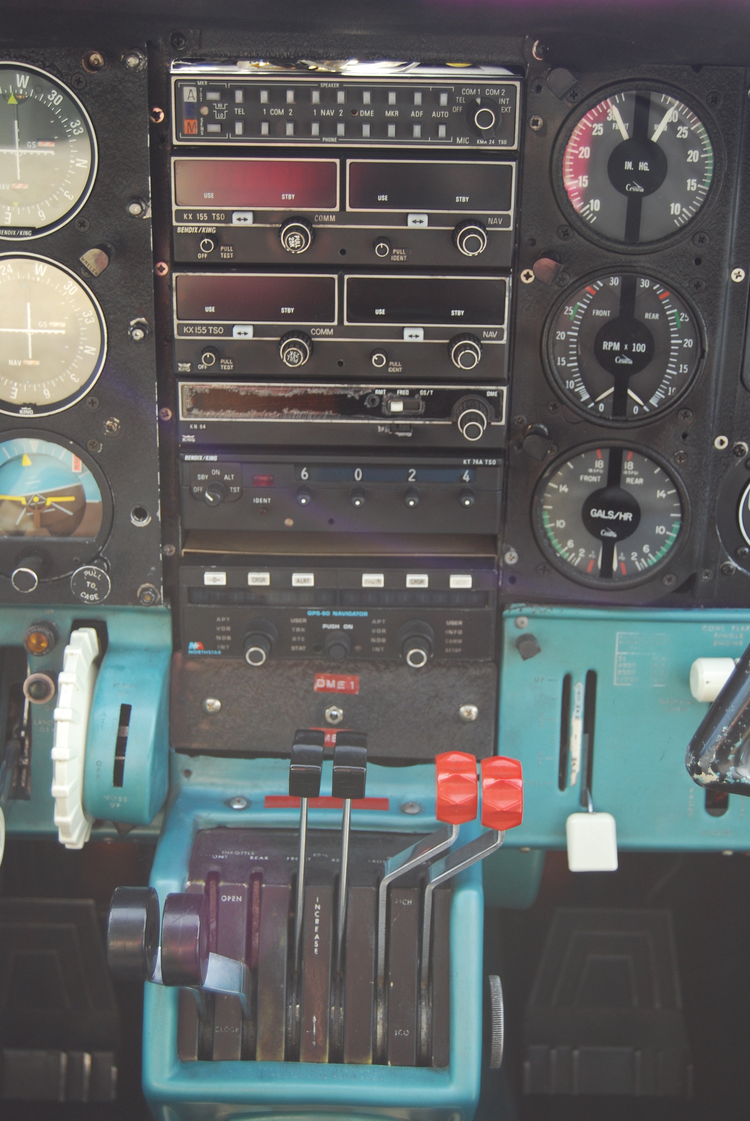

Very Nice panel, I hope to have one like it one day. I liked the avweb video to improve cockpit lighting, especially the nulight inserts. Here are pictues of mine and you'll see why I'm looking for imporvment. Much of the labeling is rubbed off.
Karl
