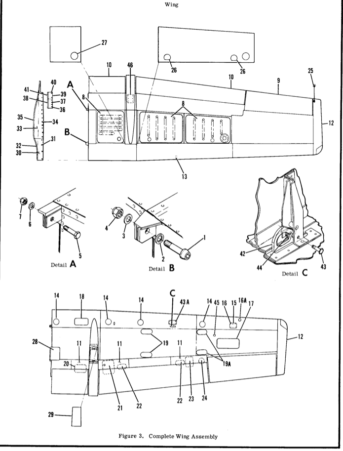

Are you referring to the bolts that attach the wing, to the fuselage? These points would be the spar attachments
The parts book does not refer to anything other than the bolts.
I am thinking that your airplane already has the wings removed (based on photos I have seen) so you must be referring to some other area?
Name:	Screenshot 2014-01-20 12.05.21.png
