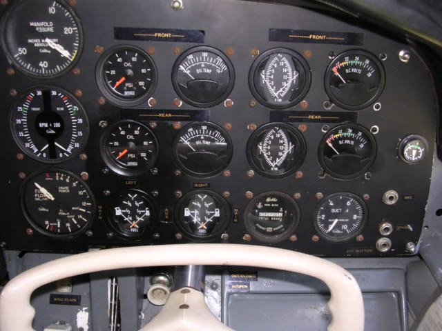

Unread 04-10-05, 01:04 AM
Francisco's Avatar
Location: Biloxi MS
Posts: 138
Dear Skyking, thanks for your responce to my question as to how to check for vacunn on the skymaster, How ever my 336 does not have the red buttons you are reffering to here is a pic ture of the right side of my panel the vaccumm gauges are on the right ( one small One Big)
