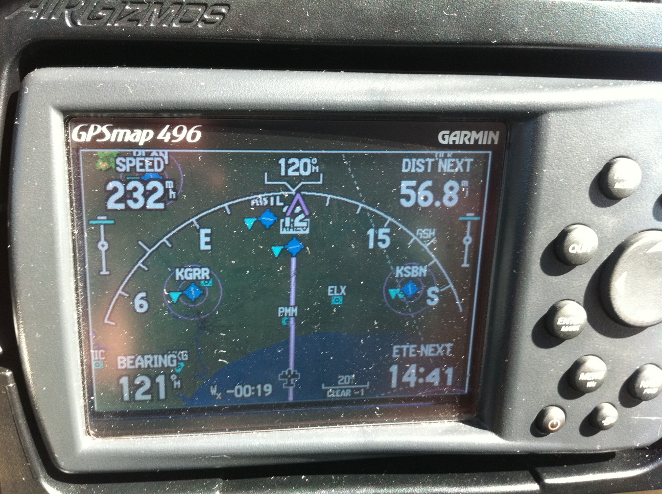

Unread 10-21-10, 08:53 PM
I was there
I remember this
