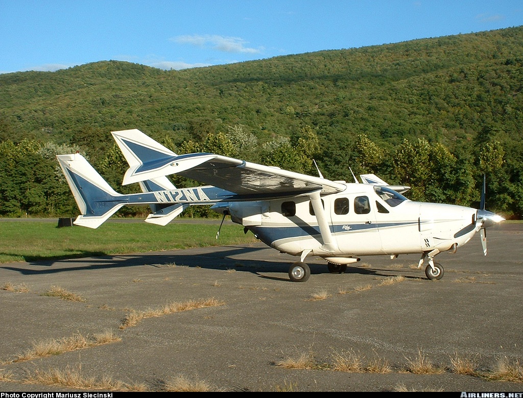

Here's a picture of N12NA
Name:	N12NA winglets.jpg

Thanks for the photo, it was posted on the first page of the thread too.
