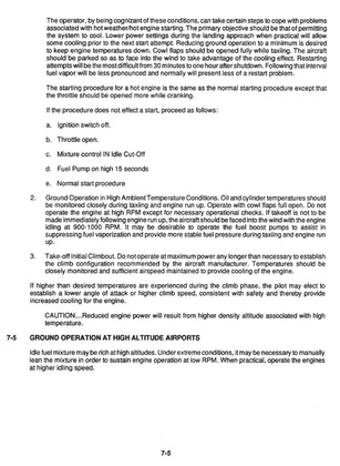

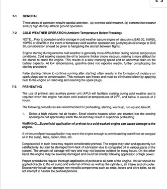

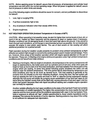

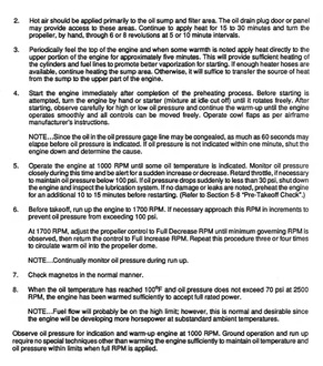

Unread 12-21-25, 07:29 AM
Jhogan0101's Avatar
Join Date: Mar 2019
Location: Philadelphia
Posts: 204
https://www.scribd.com/document/5165...t-Operator-360
