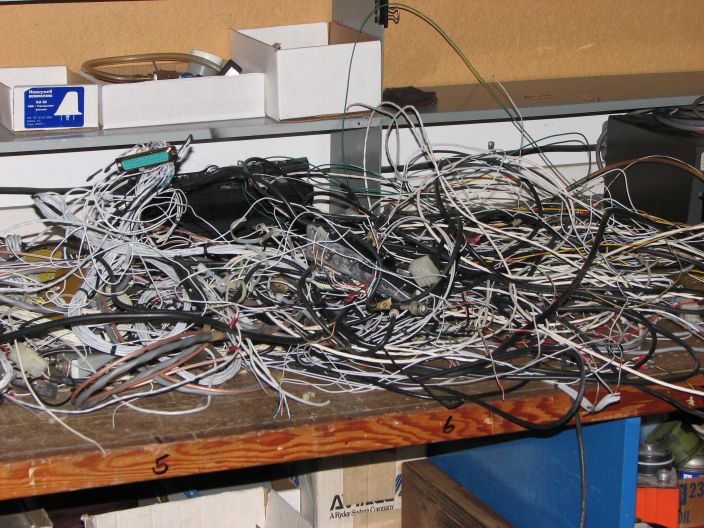

During the "clean-up" phase, they removed just over 27 lbs of wire that was just left behind with the previous avionics install. I flew around with 27 lbs of dead weight!!
This picture shows the heap of wire that was left over AFTER they already filled an apple box with wires, connectors etc.
