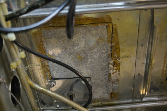

Also Jeff indicated that I should remove the black patches that are glued to the skin of the interior of the cabin. There were a couple already missing and some corrosion was apparent on the skin where the lead patch was. I removed a couple more but did not find corrosion under them. Some of them seem to be really attached strong and I had a hard time even forcing the putty knife under them. Should I still remove them all? Even if there is no corrosion?
I haven't looked under the floor yet. I assume there are some of these down there too?

there were plenty of those lead sheets in the floor of my plane ( '77 T337G ) and there was corrosion under most of the ones near the door. My observation was if they came up relatively easily, there was corrosion underneath. If they were really stuck down well, there wasn't much if any corrosion, like the picture you showed with the shiny aluminum underneath. My guess is that on those sheets, there was glue between the lead and the aluminum preventing contact, water intrusion and thus, dissimilar metal corrosion. The right thing to do is remove all of them just to be sure, but I think a reasonable argument could be made based on the above observation to be selective. I will tell you I left some behind that were stuck well and were in hard places to get to.
