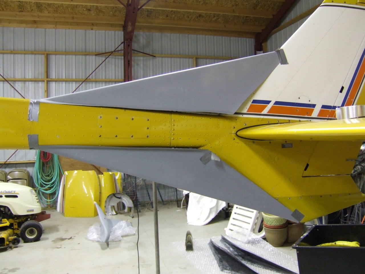

Last night we pulled off the old wing tips and started to fit the new Lightning Wingtips from Owen. It's going to be fun and effective. What difference. I'll fog a little Boeshield in there now that this access is open too. More to come on the wingtips later. Here are some progress pictures, one of the interior shots shows the removable panel that provides access to the main gear components inside the cabin. They used velcro to attach the panel and it works really well. The annual is complete except for the gear swing and performed to perfection by my qualified IA. We are winding down and now before I know it we will be at the paint shop. Then a new thread will be posted on the trials of painting a Skymaster. Stay tuned.

Herb,
As you may recall, I am in similar (but less public) process with my plane at this moment. I am very interested to learn more about the wingtips you are installing, because I wanted to install new wingtips too, but was told there are no wingtips with landing lights in them (like the RMD ones I have on my other plane). In my other plane I have HID lights in the wingtips, and I can light up this side of the planet when landing - apparently no such luck for the 337G.
Can you send me more pics and maybe a link on your wingtips, so I can investigate further?

I installed the Rosen visors several years ago and experienced similar difficulties. As I recall the stiffeners were not even close to the proper size, shape or form requiring a couple of hours of grinding, bending, trial fit and repeat until I had a servicable arrangement. I found the visors to be an effective sun block but found their two claims to fame, transparency and adjustability, more hype than substance. You wouldn't want to bet your life on spotting conflicting traffic while trying to see through them and although they are somewhat adjustable the sun is somehow always just out of their range. On the wingtip installation; I assume you or your mechanic have strap duplicators but if not they are a slick little tool for match drilling the new tips to the existing nut plates that you definitely want to employ.

Part of the Horton STOL STC is having the wingtips. How does having the winglet wing tips affect the Horton STC?
