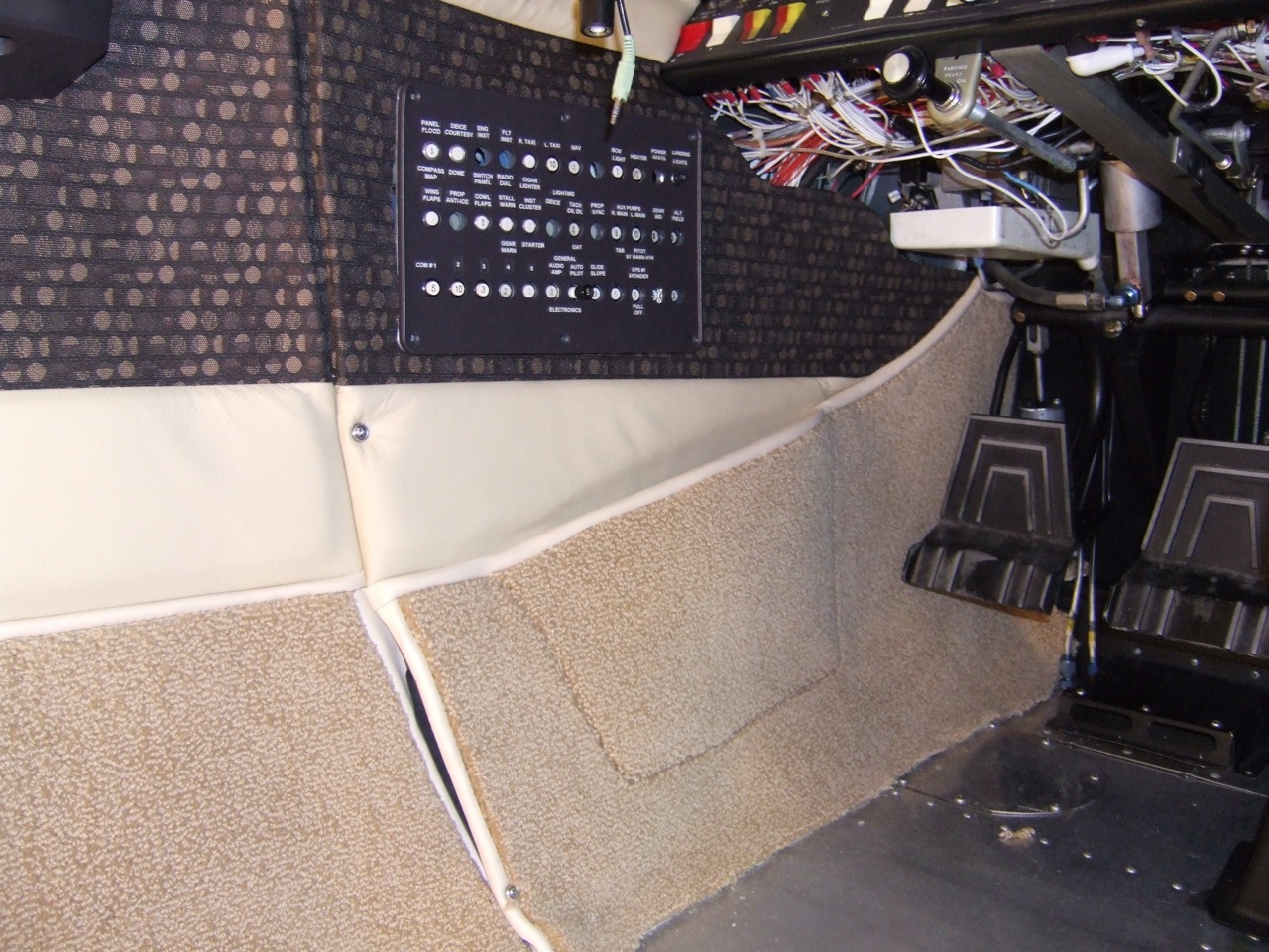

Just completing my interior and I used a label maker which in the short term looks fine but I am expecting to have to possibly replace some of the labels in the future but this is very easy to do. Definitely the website in the post above would be a more permanent solution.
http://www.337skymaster.com/messages...0&d=1235666061

Mine is a '68 model which is pictured in the link on my previous post above. Yours is very different than mine but the label maker would still work. I can get you a better picture next week as I am out of the country right now. Here is the type of label maker that I use and these have several different types of labels, fonts, colors, etc. They work really nice and I use mine in all kinds of circumstances.
