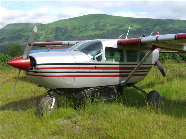

I saw this one on Kodiak AK.
Granny Hairy

I can't be certain, but this might be a 336 (I can't see rear-engine air scoop and cowl flaps). If that's the case, it's a lot easier mod because the gear is fixed, so no worries about fitting the bigger tires inside the fuselage.

DBrugg DBrugg is offline
Join Date: Mar 2007
Location: Minneapolis
Posts: 25
You are correct!
I just thought is was interesting.
I hadn't seen one before.

The picture is a 336. The top of the frt. cowling is straight compared to a 337. The incidence angle of the wing and fuselage is different. When flying around always feels like the plane is trimmed nose up.
