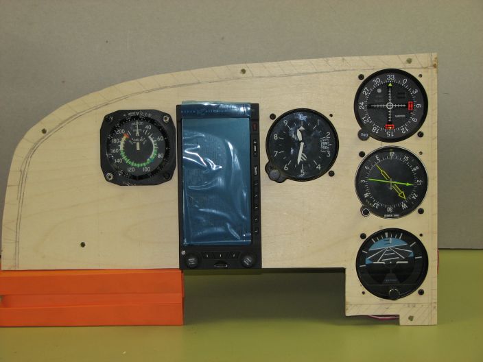

This is what the panel is going to look like so far. Again, the ADF and attitude instruments should be reversed.

I know that the Aspen is the latest, coolest thing out there, but in your considerations, did you consider the Bendix King PFD??
I like that it is larger, and very cool looking

Very valid question. Short answer: no. I did not even occur to me. I guess this one went past me because I do not regard myself as a B/K fan.
But at quick glance the B/K MFD looks very cool, I agree. I'll have to read up about it first though. For starters, if I have to give advice so far to others planning a similar venture with their panel, I would caution on available estate on the panel. These panels are a lot smaller than we think. The B/K is 8.5" wide x 7" tall. It actually works out better (read:smaller) than the 3-piece Aspen glass, which is (per unit) 3.5" wide x 7" tall. Something to consider indeed. With my setup I do not have enough panel space to install all three 2" mini instrumetns in a cluster together, hence the mini-ASI and mini ALT on the left side and the normal attitude indicator on the right side (it would just look funny if it was a mini too).
Another winning ingredient is the cheaper price for the B/K vs. the full set of 3 Aspens.
OTOH, the Aspen can direct the MFD to take over PFD duties in case of failure, which the B/K can't do. It is very unlikely that all three or even two Aspen screens will die simultaneously.
Make no mistake, I am still very smitten with the Aspen setup. But I do know of at least 2 problems it has (defaulting to HDG mode during landing and attitude problems in certain conditions), but Aspen is working on a software solution to be released (hopefully) soon. I would like to study the B/K unit as well and see if it has similar quirks.

Originally Posted by GJ Humphrey View Post
Notice in the mock-up panel in the photo submitted by Jakes Dekker, that the Aspen is offset about 1.5" to the left of the control wheel shaft. This is because the Aspen fits into the hole left by removal of the attitude indicator, and on my ship and, apparently, Dr. Dekkers', the AI is not centered over the shaft. Once the Aspen is installed, it's such a Christmas tree, with all the glowing colors and wealth of information beautifully and compactly displayed, the off-center position of the unit seems really assymetrical and weird.
It is a very valid point. Actually, we were paying a lot of attention to that. We were torn over the two choices we had: (a) centre the PFD over the steering column, or (b) centre it over the amber warning light directly beneath it. Option (b) made more sense for 2 reasons: (i) the basic structure of the panel support allowed for it very easily, and (ii) visually it looked better when centred over the yellow warning light. We also pasted real-life size pictures of the MFD's either side of the PFD, and when the area covered by Aspens is bigger, the little offset is almost not noticeble.
It's weird, but in the "old" steam gauge configuration everything was also 1,5" off to the left - I did not even notice it then.
