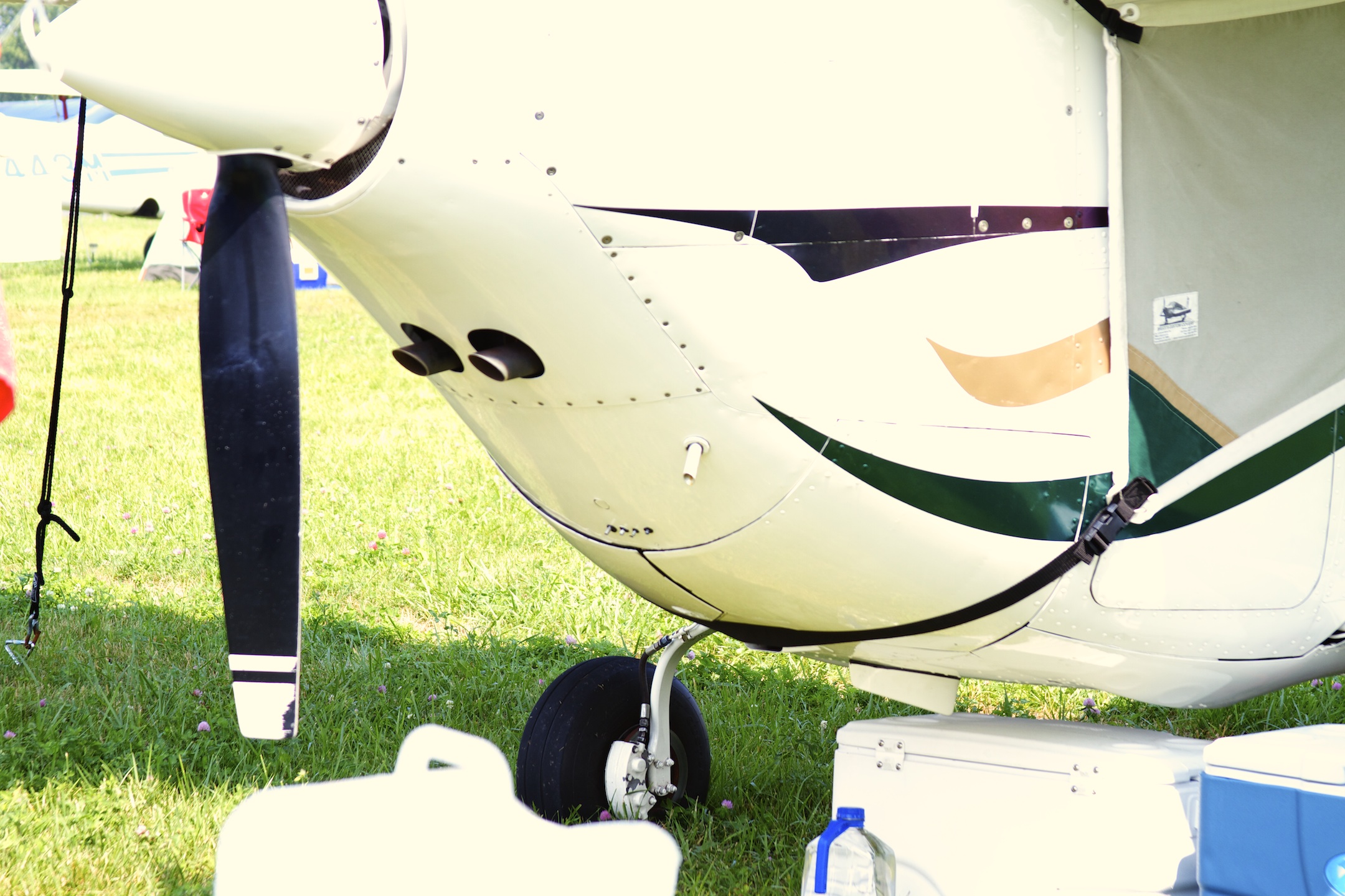

Originally Posted by Gord Tessier View Post
Hi, has anyone moved the rear engine oil drain outlet away from the top of the engine and located it where it won't spray oil all over the rear prop?
I saw this Saturday, I think this is what you are referring to
Name:	N5383S A breather sml.jpg

Thanks Herb, I will show it to my mechanic.
Gord

Oil vent
I ran mine to nearly same location to accommodate an oil/air separator.
