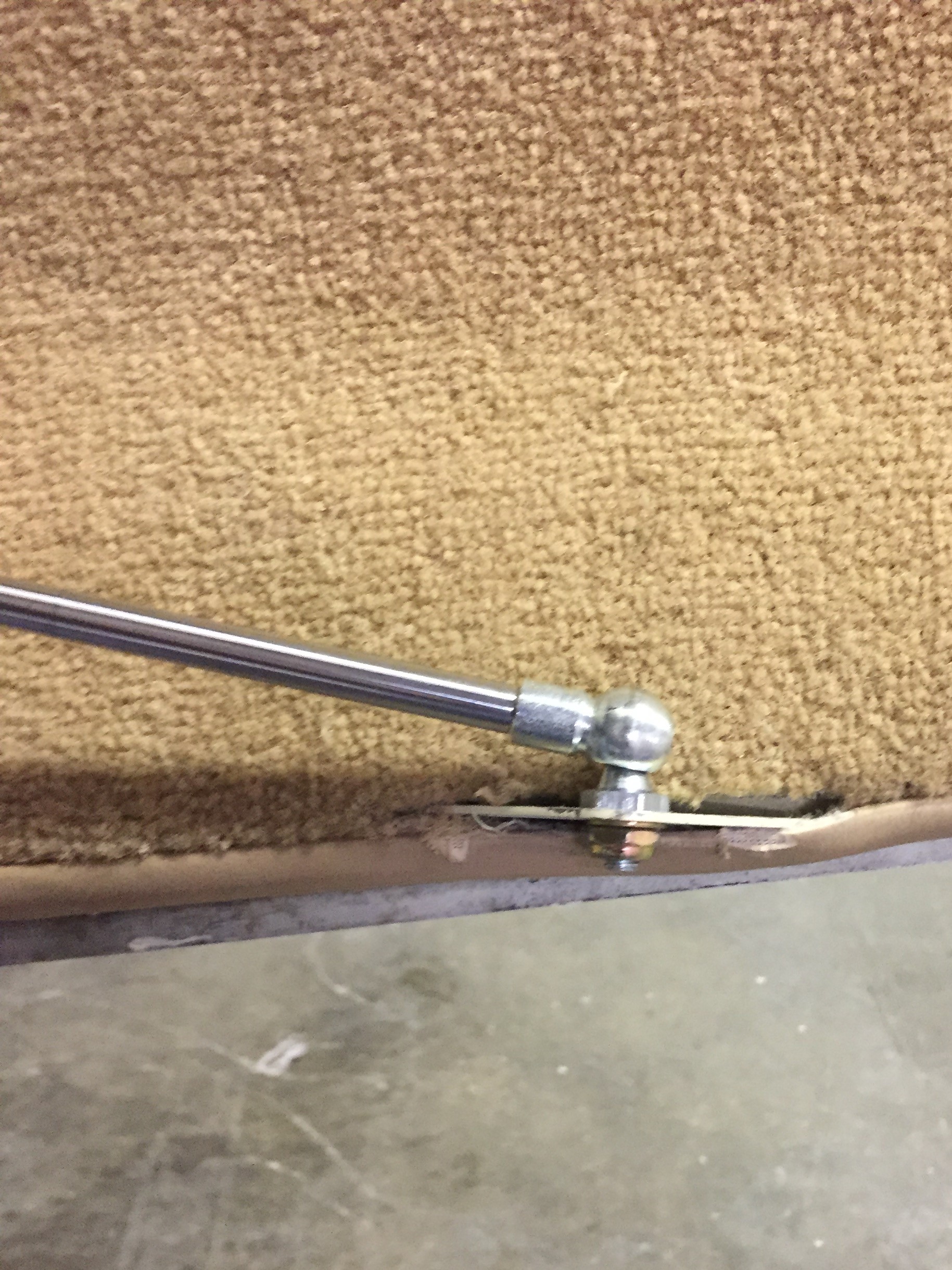

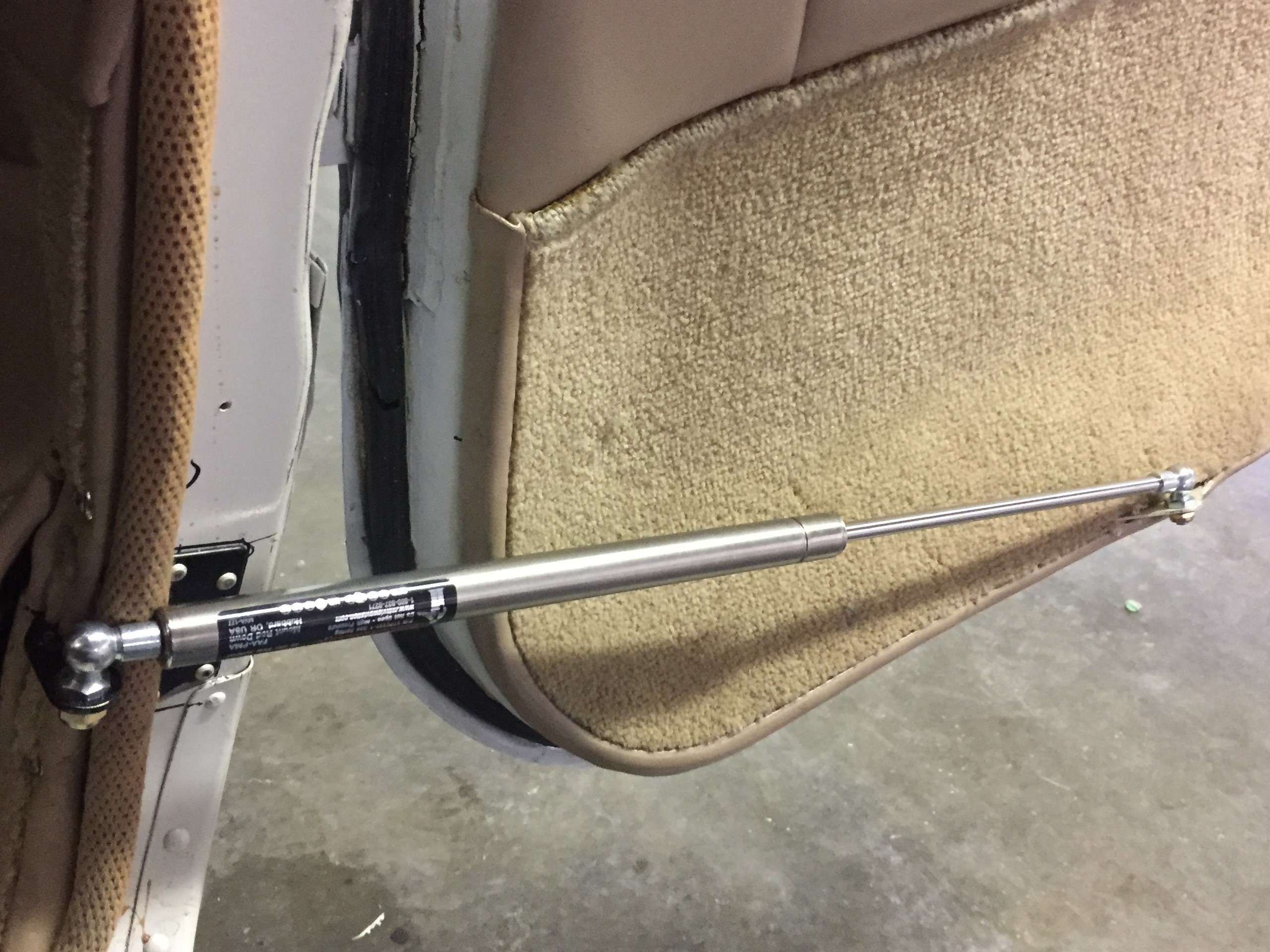

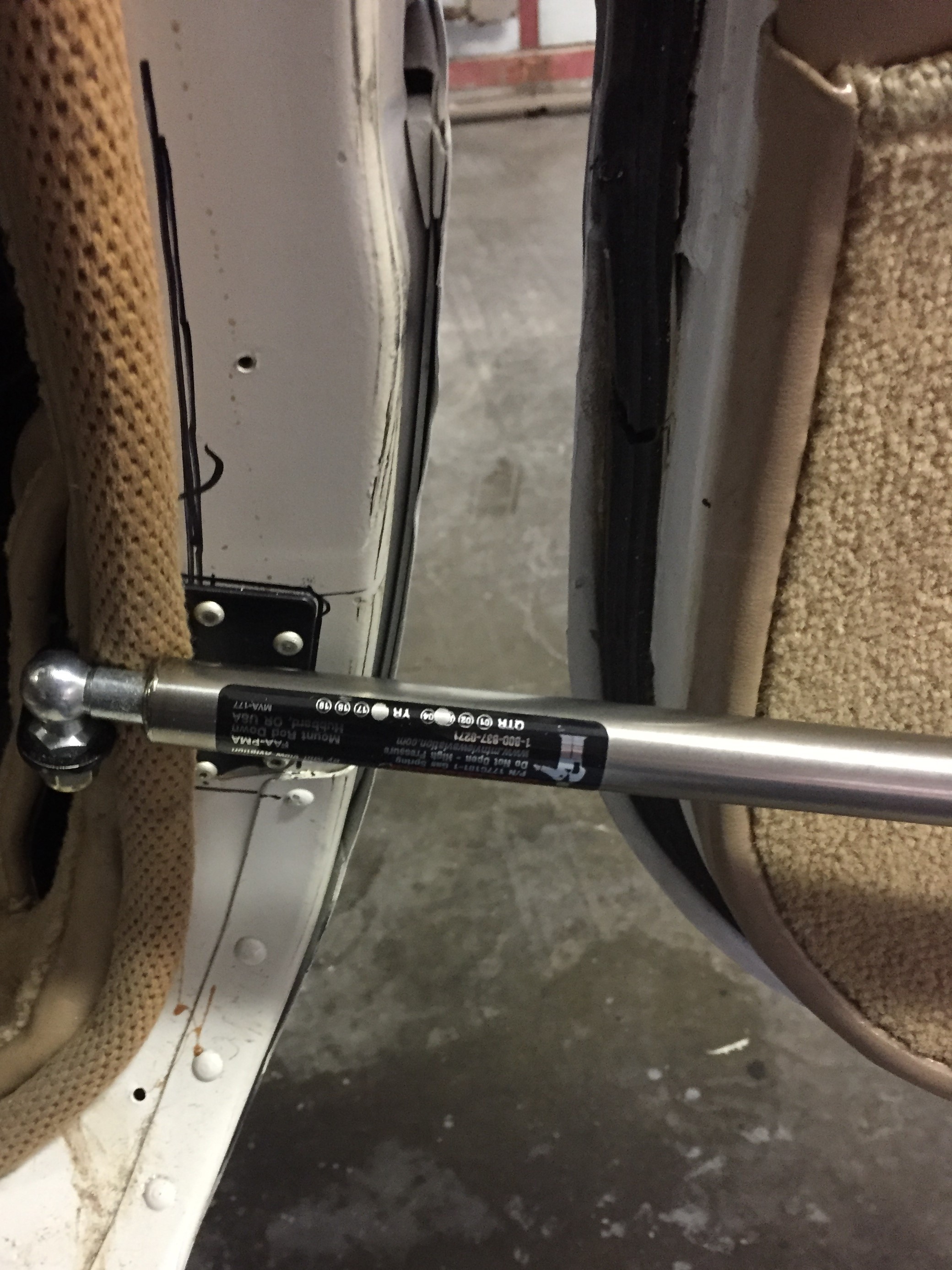

I purchased the door steward at MTN View Aviation. They were very helpful and they also had previous 337 forms that had been approved. My mechanic did a good job with the installation and it works excellent. Mine has now been approved.
Howard
