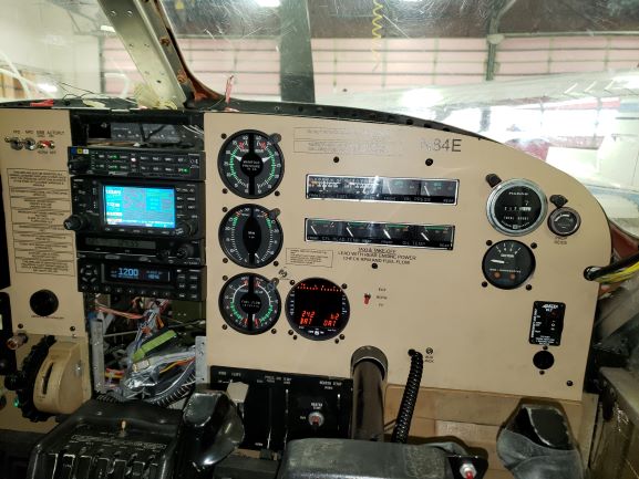

Current Panel
This is what the panel looks like today...

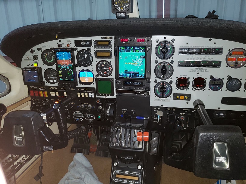

Scott:
I think you will have a great panel with the Aspen 2000.
I had an PFD Pro 1000 put in when I bought my current P337. Love the functionality.
See attached picture of my panel. Only change was last week when I swapped out the Dynon D2 for a D3.
Agree with Herb on the yokes. Saito does a great job. Had them done on my previous aircraft. Came back looking brand new.
Post pics when you are done. 84E has a good home....
Richard
