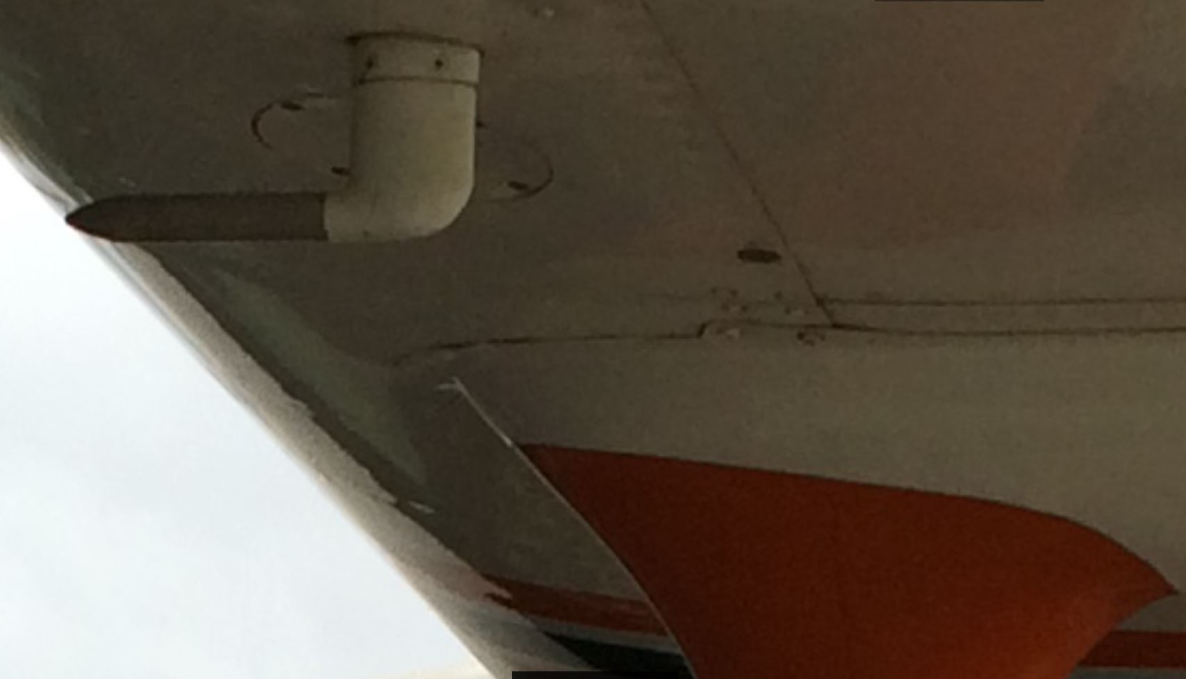

What’s up with the jack stands?
We bought our 337 in December and bought the jack stands and jack pads from aircraft spruce. Today we were trying them out while changing a tire, but this doesn’t look right to us. Really don’t want to swing the gear with this setup unless one of y’all can confirm this is how it looks or tell us what’s wrong. Thanks.

My jacking points go in straight and stay straight. Something seems off there. Where's the nearest inspection cover?

Nope
That is not right...can't tell from the photo where this is exactly but jack point is located on the fwd spar. It should not buckle or be at an angle like that - the spar is solid. Could you take a photo from another angle - from wing tip looking inboard?

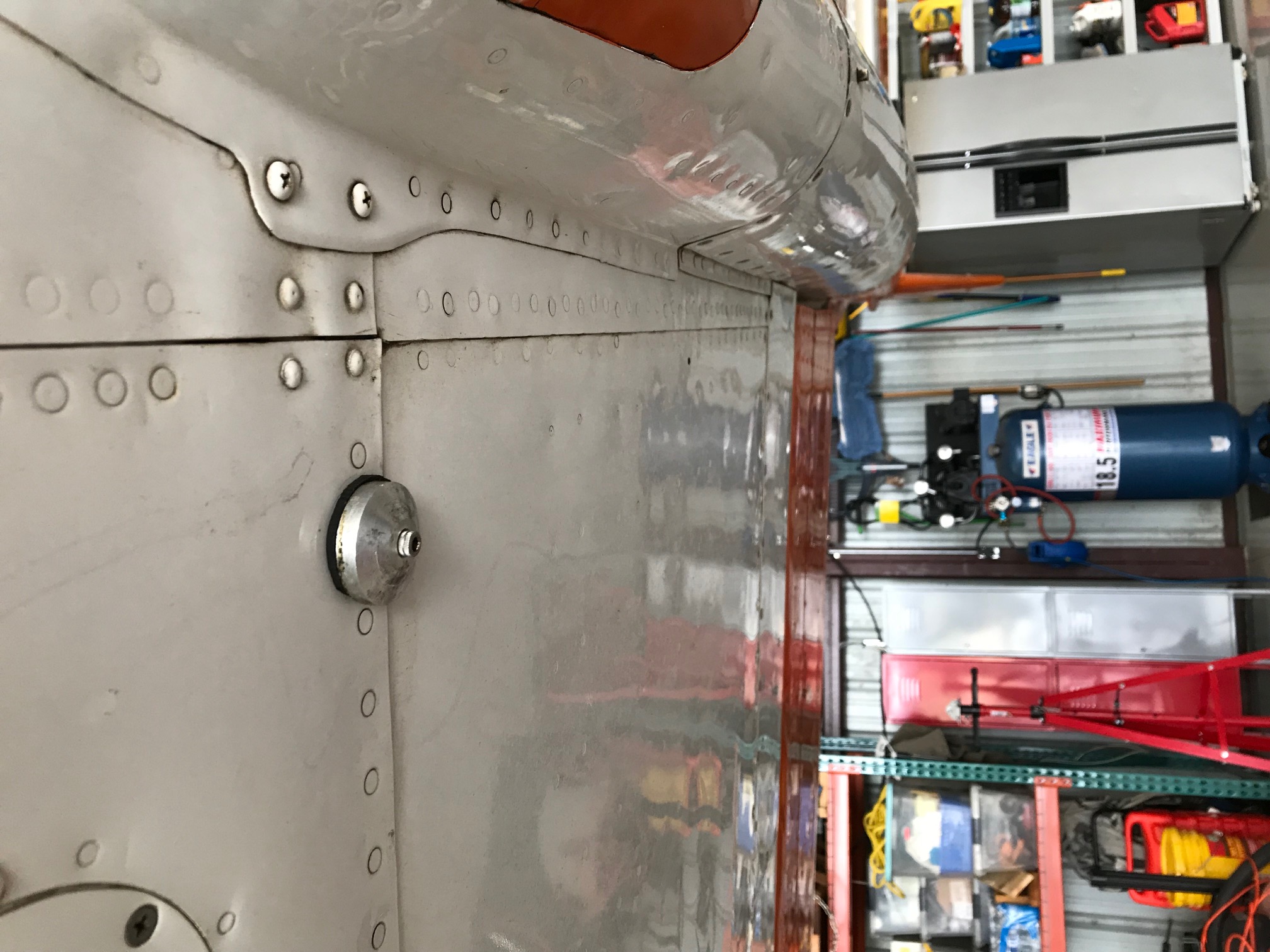

location of jack point
I just pulled up a picture of my 1966 337A jack point. The dark circle is where the screw and washer is inserted into the jack point, which is along the rivet line for the wing spar. Looking at your picture is a little different, as the rivet heads are raised (AN470) and not flush like mine (AN426). This could be due to a previous repair, or a different model. Either way, it looks to me that the jack point on yours is in the incorrect position, and aft of the spar. The double row of rivets running span wise is likely the spar location. Your jack pad should not be behind the skin lap, but in front of the skin lap (for reference).
Was there any repairs made in that area, and the hole for the jack pad incorrectly located?

Can't add much except to say that this is seriously deranged. The central axis of the jack pad should be very nearly vertical when threaded into the spar. This condition, at least as it appears in the photo, should be impossible if assembled correctly. Is the bottom skin actually as buckled as it appears? What does the starboard side look like with its jack pad in place? Threading a longer rod into the wing would dramatically illustrate any misalignment. Not only would I not jack the aircraft until I understood the problem, I wouldn't fly it either.

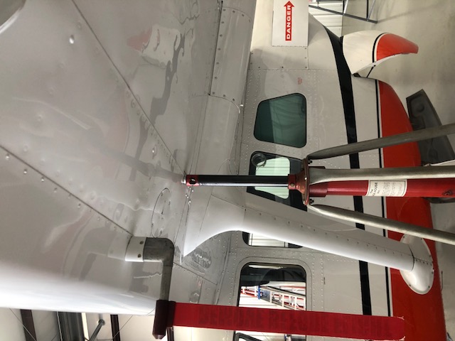

Here is a picture of my jack pad installed on the RH Wing. I am not sure if these are Cessna Original jack pads, but they are crap. I am going to purchase a set of those yellow Bogert pads for my bird. With the shape of the jack pad ball, they will fit better in my jacks (Alpha Jacks) and be much safer.

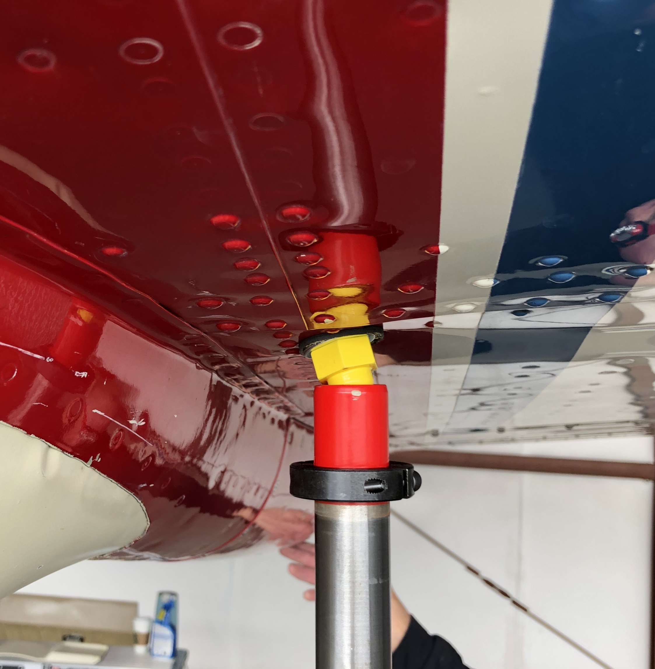

I have the Bogert units. They fit well and keep my plane stable on the jacks.

Any chance you have a picture of your plane on the jack stands using the Bogert jack pads? This is what we have, but if you look at my picture it looks a little scary and unaligned.

Yup, posted here.
http://www.337skymaster.com/messages...9&d=1503100618

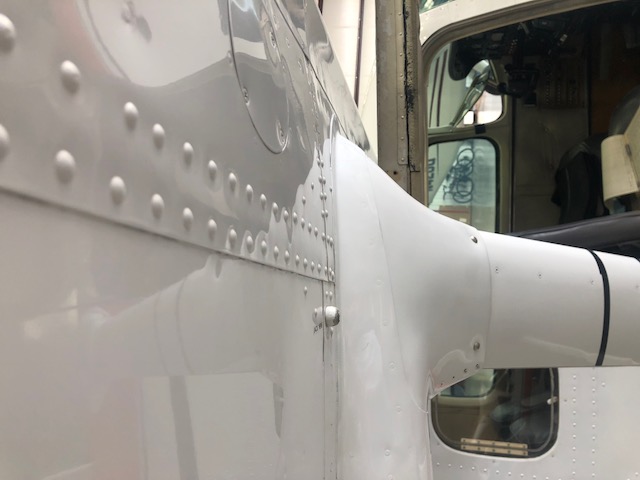

Here is one of our aircraft on jacks. We just leave the jackpads on all the time.

Thanks for the pictures. Your jack pads are the same as the old ones we had before we bought the yellow Bogert pads. I'm also glad to see that the location of your pads is the same as ours. We may try putting the old pads back on and see how they line up with the jacks. This is really strange.

Tripp,
I would recommend looking inside the wing at the structure before you jack again. Something does look right in the first picture you uploaded how the jack pad is at an angle. Just a thought.
