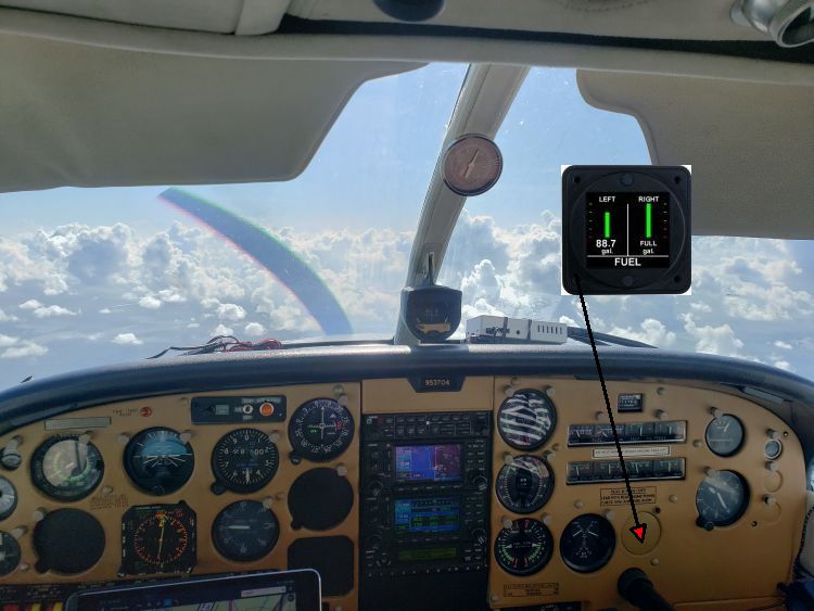

I have been looking at CiES fuel sensors and Aerospace Logic display since I got into my plane in March. Have spoken with both CiES and Aerospace Logic. Also Possibly newer Electronics International engine monitor with the CiES sensors. Been slowed down with other maintenance items. Of course always dip the tanks.
Unread 09-25-19, 03:04 PM
The more I look at them; I'm thinking the Insight Gem 4 Skymaster over the JPI 760. I like the display a lot better. I'm also thinking of the Strike Finder as well. I have the ForeFlight stuff on the iPad, but I love doubling up on information.
