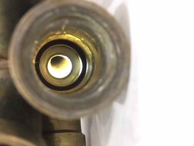

I just went through this. The issue of leaking past the valve is from the little balls not sealing on the seats. The selector valve has a small well in it that can collect water. I think this contributes to the problem. The ball is held against the seat with a spring that is likely rusted. There will also be some rust on the seat that is causing your leak-past. You can remove the valve and see the ball/seat assembly. Don't remove the little clips that hold in the spring. They seem to be impossible to find. If a replacement clip/retainer was available this project would be pretty easy. I was only able to find one guy that was willing to look at them. He wanted a fortune and was a bit on the grumpy side.

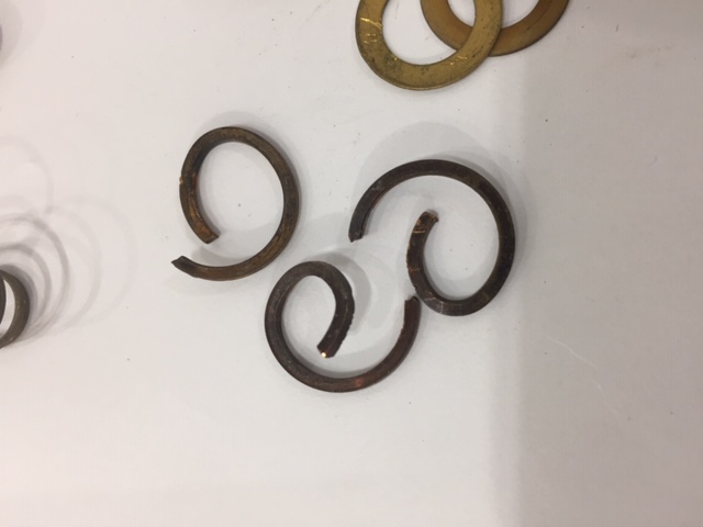

There is! It's this little self-destructing thing that springs itself out of position once removed.

I dug out the old fuel selector valve. I have no recollection of how to attach a picture so I'm attaching several pictures. My computer has a .020" diameter thumbnail of the picture which is useless. Unfortunately I don't know how to add any descriptions to the pictures.

oh my goodness. that internal clip that holds the spring does look like it will be a problem. I wonder if an internal c-clip would work in it's place.

I will measure the thickness of it tomorrow. I don't have the right caliper to measure the inside groove diameter where it seats. One thing I would encourage is to take pictures and mark where the tubes go before you remove it.
