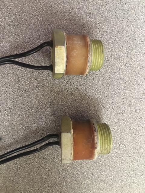

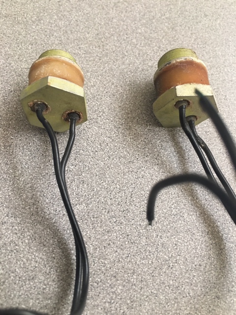

Can you post a picture of this pickup? I might have an extra.

Is this what you are looking for?
