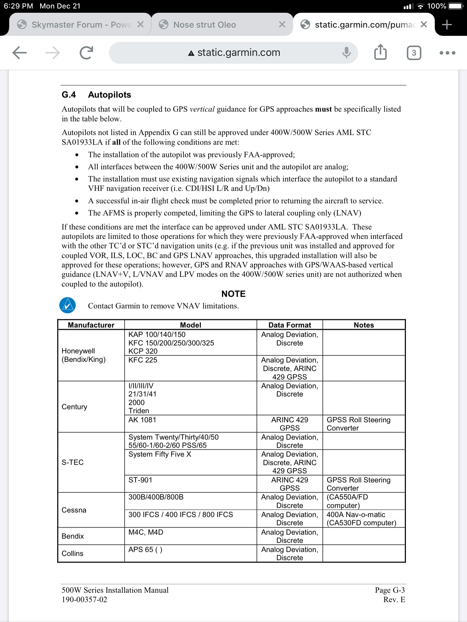

Using an original 400A autopilot I believe is not authorized with the Garmin WAAS navigators for LPV approaches. My understanding is the 400B is approved for LPV.

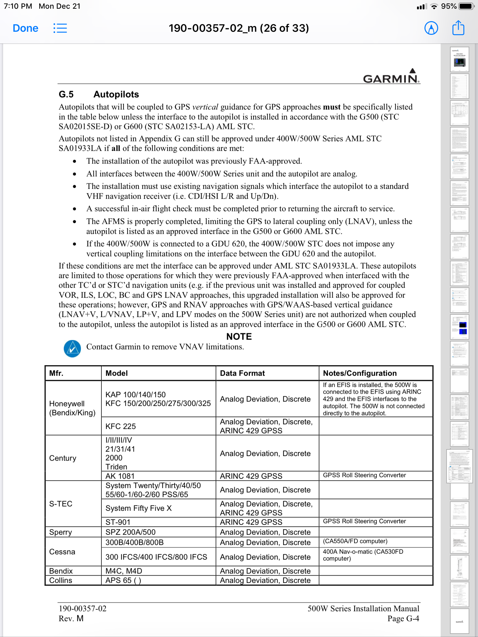

The 400A can be used for LNAV minimums, however, LPV minimums, are not authorized. Attached is a page out of the 530W installation manual rev E.
Dan
Dan
Interesting! I have Rev K of same manual and it does not have that limitation. Nor does it have most of the autopilot interconnect diagrams.

My Rev M. Manual has the same info.
Dan

"Note: Contact Garmin to remove VNAV limitations."

Talking with Billy today, engineer at Garmin, we can’t get LPV minimums with the 400A autopilot, LNAV minimums only. The 400B that is approved is a different animal compared to the 400A.
