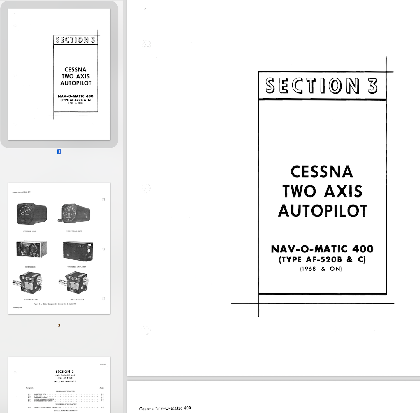

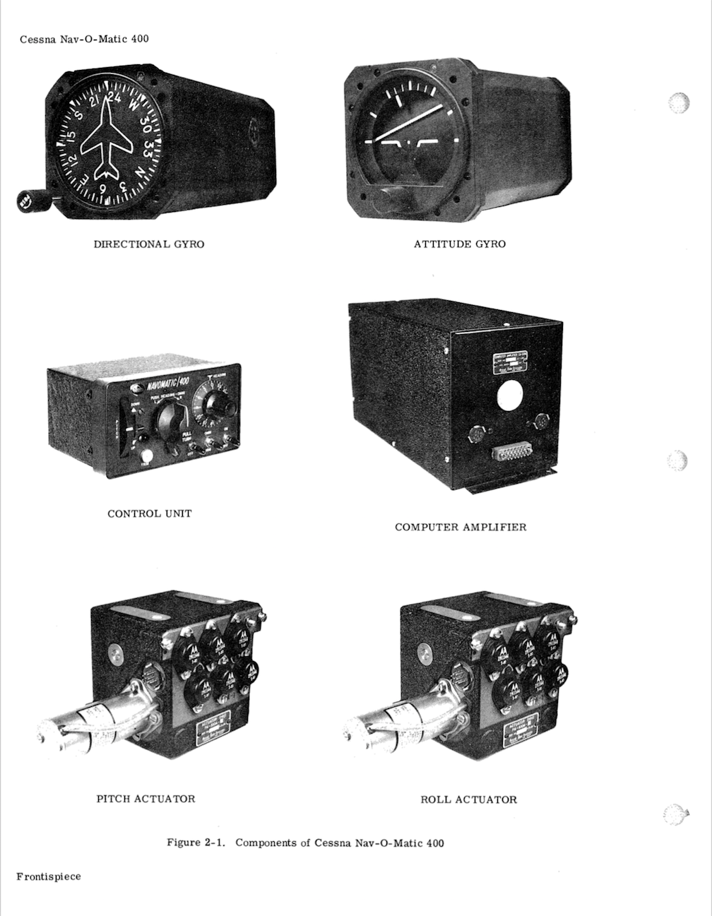

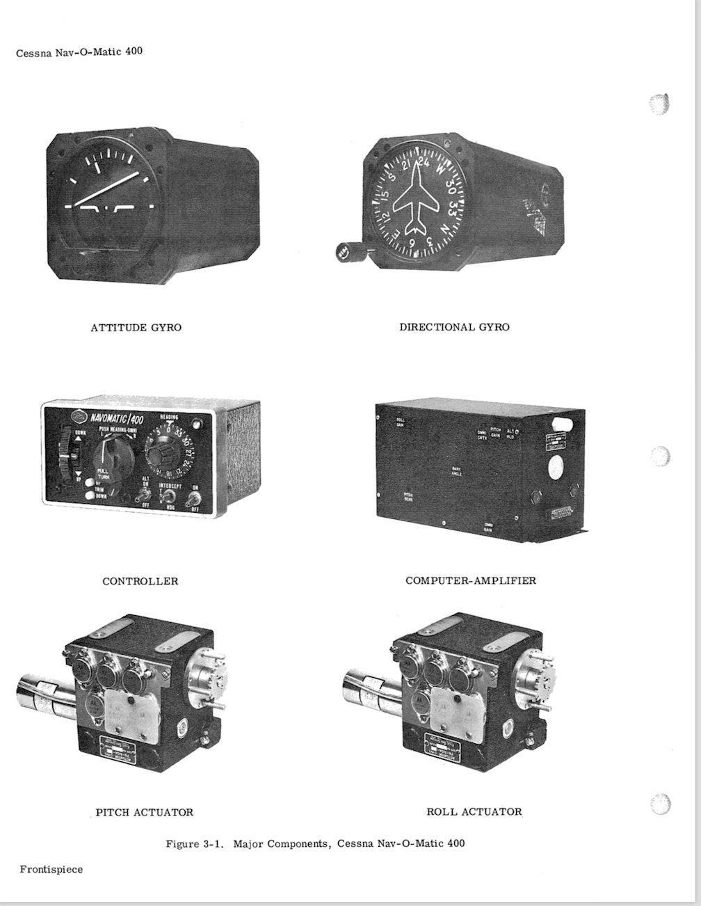

The Nav-O-Matic 400 (Straight 400) had two versions that I am aware of. There was an early model with a little different control head and then the current unit used up to about 1969 I think. It seems the change from the early 400 to the latest 400 was about 1968. Attached are a couple cut sheets of the systems
If someone needs other info on the Nav-O-Matic 400 I have a couple files about these units. Service and Parts manuals and user manuals

Herb. Thanks for the pictures. I think I have the system on Fig 3-1. But I'll have to go to the airport to check. I may need the manuals you have. I did download the schematics for the head and computer, from you in the past.

Thanks for sending me the thread. I checked the autopilot I have and found I have both types shown in the pictures. The one that was installed in my C337 is FIG 2-1 but the other system I have is FIG 3-1. I contacted Autopilot Central (Tulsa)and Mayday (Michigan) they both say that getting those OLD navomatic (straight) 400 can be difficult to fix and or find the parts. It seams that my 400 requires a DG and a AI. The AI I have is the old type pictured. I was hoping to get a more modern AI that shows more details and color coded (blue/brown). Autopilot Central is quoting about $10,000 to get my system working/installed with a DAC converter.

Hello again. I'm looking for 1965 Navomatic autopilot manual. Probably the install manual as I'm trying to determine the DG and AI that are required for the 1965 year 400 Navomatic. I downloaded the manual that you had, but it only shows Chapter 3 and Fig 3-1. My 400 is the one with only one trim light on the control head. If you have Chapter 2 and Fig 2-1 I'd appreciate it.

TO Herb.
Thank you for the manuals. You won't belief it but I have those on CD. What I don't have is the manual you sent me a while back. I don't know what manual it was but the title was Section 3, with a Fig 3-1. BUT I need the Section two of that manual. That's the pre-1966 model. Any chance you have that one? Also while researching Cessna manuals, I learned that according to the Electronics parts manual the original 1965 C337 lists only the Navomatic 200 and 300. The manual states that the 400 was installed starting with serial number 240+. I think that's a 1966 337A. My 1965 serial number is 200. I've asked one of the avionics shops that I'm working with if I can install the 400. So far no answer. I cannot belief that there are no 1965 C337 with 400's installed. Maybe owners of the 1965 models can let me know if they have a 400 installed???

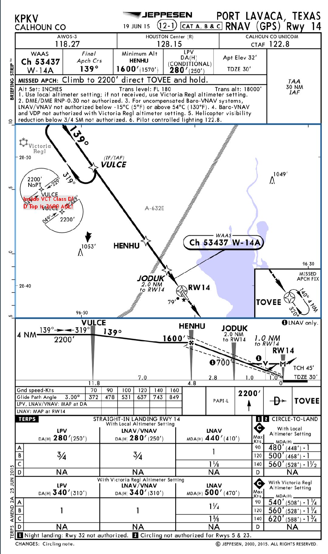

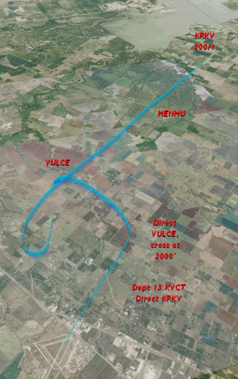

I did a very short flight Friday in LIFR to go work with a guy on a High-Performance endorsement. KVCT-KPKV is a short 17nm flight that requires a climb from SL to 3K, a course reversal, and then the LPV approach. The 400A flew it smoothly and to perfection. I attached the 3D View of my track and the approach plate.

Unread 01-24-21, 04:14 PM
Posts: 2,285
Maybe this is the one
File Type: png Screen Shot 2021-01-24 at 4.12.51 PM.png (346.8 KB, 1873 views)

No sir, that's the one you sent me before. That is for 1968 C337. I take it you don't have section 2?
Thanks for your continued assistance.
