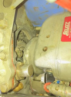

To clarify, my oil pressure had dropped to the bottom of the green and was then bouncing between about 10 psi (there is no "10 psi" indication, but it was just above 0) and the bottom of the green.
On the advice of one of the other members I am working with the mechanic for me to do the work and he will look over my shoulder. I will be starting work on it next weekend starting with the oil cooler and oil pressure line. Based on the rate of oil loss (4 quarts in about 6-7 min) it has to be a pressurized part of the system OR a monstrously large hole in the case. All the oil is from the back half of the engine so it is not the crank seal or the prop governor system and the rear engine does not have an unfeathering accumulator. I am hoping for a smoking gun - cracked oil cooler/blown gasket. I doubt it is the oil pressure line as that is small and the gauge was still working, albeit low and fluctuating.

My experience be it correct here or not.....if the rear engine alternator nuts ever come loose, the alternator will drop and let the oil out, just throwing it there.....happened to me IN MEXICO.

Excellent! Another easy thing to check, thanks for the insight!!!
