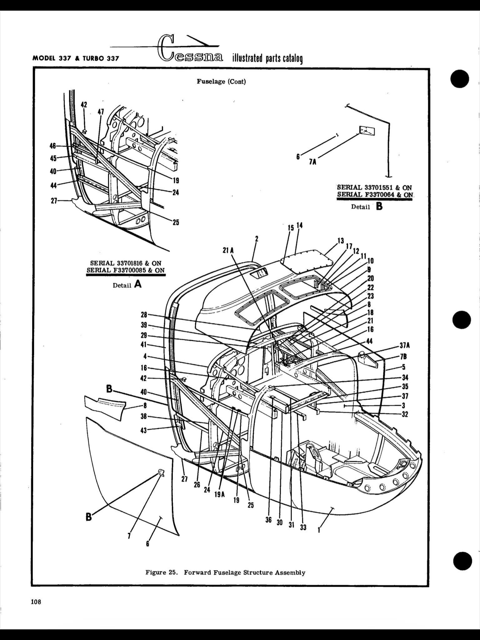

Hello All,
On the top of the engine cowl just forward of the windscreen is a panel which is held down by several cam locks which permits access to the back of the instrument panel from outside the airplane. On my 337D the panel has a gasket which keeps water from seeping inside. I've spent the last two hours looking in the IPC and not knowing what that is called, I need the name of that part or the page/illustration number in the IPC. Or if you know the part number or where to get the gasket it would be very helpful. Thank you

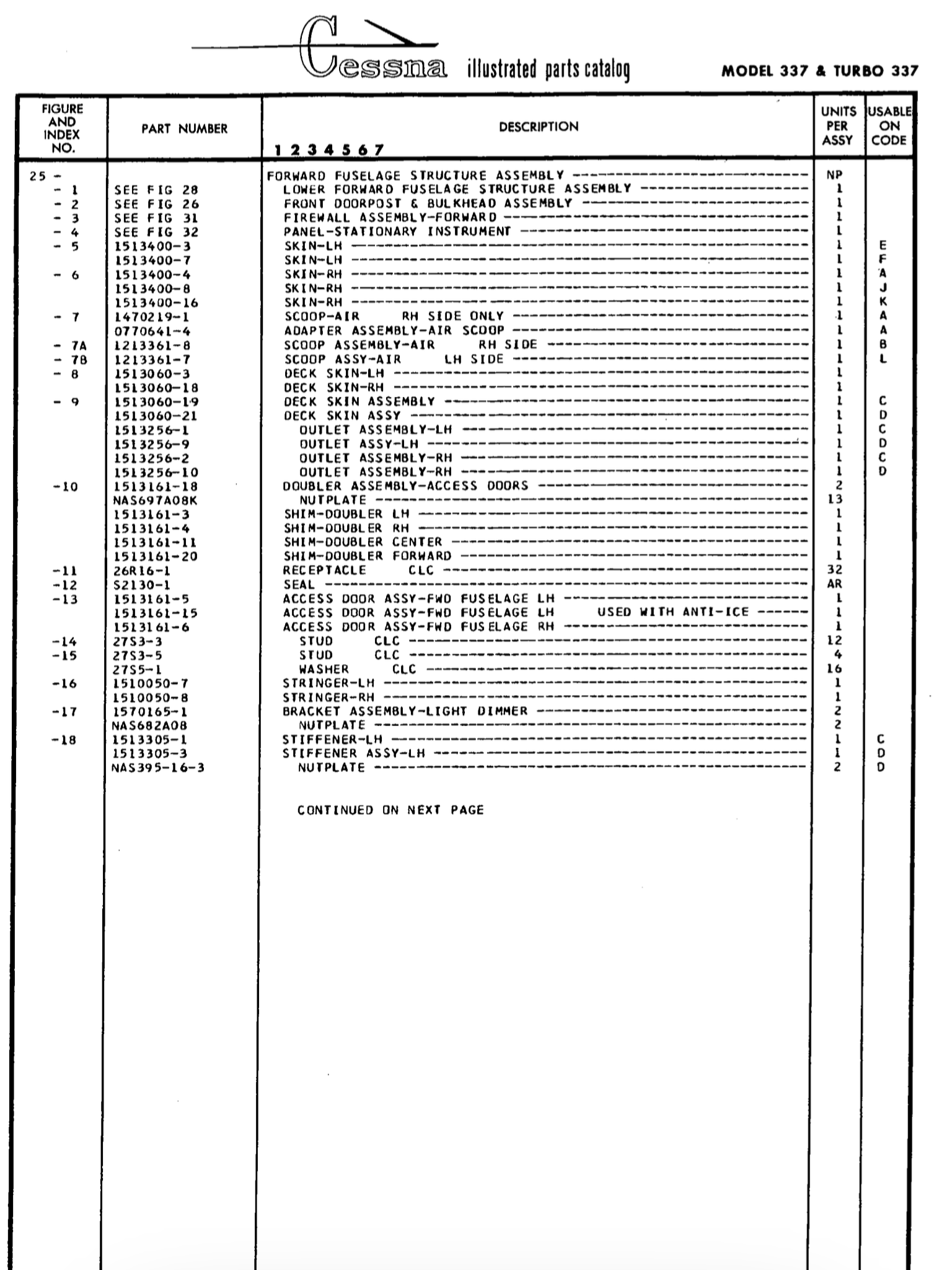

Posts: 293
These pages are from the G model IPC, but maybe it’s helpful?
Also, search the board for “avionics access”, there’s a couple threads about sealing up those access panels with RTV in the cups and weatherstripping on the panels.

The part number is S2130-1 and is the rubber seal that is glued into the channel that runs around the perimeter of the avionics bay access doors. Textron has over seven hundred feet in stock.
I replaced them on my plane about two years ago. At the same time, I replaced some of the capped camlock receptacles that had rusted holes in the bottom that had been allowing water to drip into the avionics bay behind the instrument panel. Problem solved.
