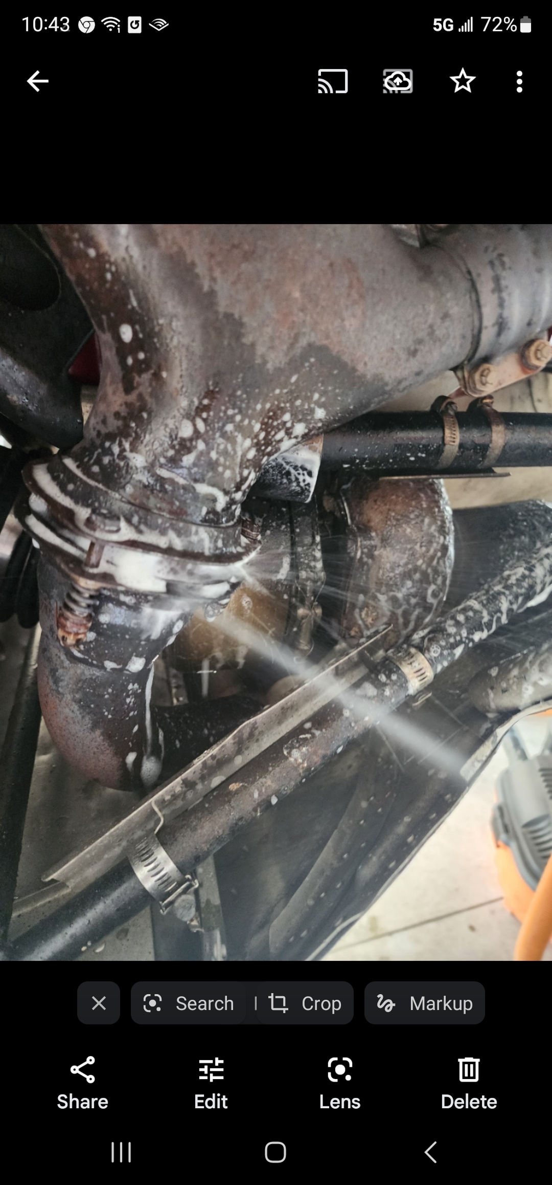

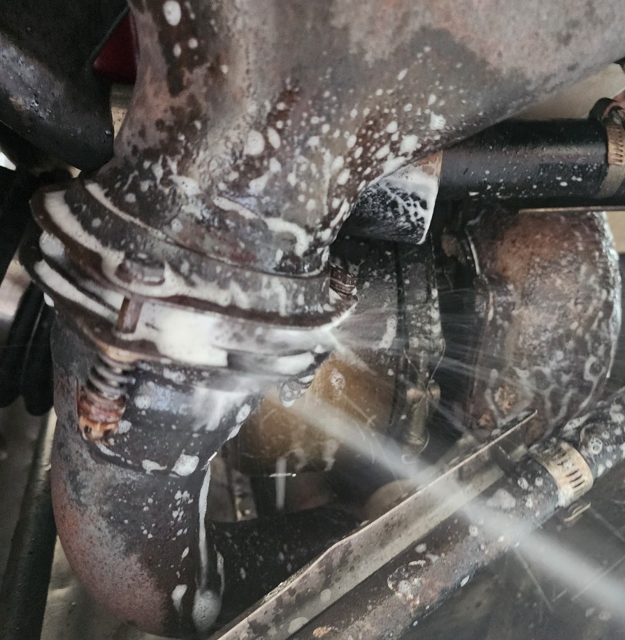

Found the leak! After pressurizing the compresor and the exhaust system I found a massive leak at the collector/ball assembly. Also just a few minor leaks on the injector o-rings. Thanks for all the input from the past and present. Joe
Unread 07-12-23, 09:52 AM
Would you mind posting a photo of the exact location of the leak? As close-up as possible? TY!
Unread 07-12-23, 10:46 AM
Joes Joes is offline
Join Date: Dec 2021
Location: Abingdon, VA
Posts: 95
Here ya go
File Type: jpg Screenshot_20230712_104232_Photos~2.jpg (205.1 KB, 5964 views)

Unread 07-12-23, 11:10 AM
Thumbs up
Originally Posted by Joes View Post
Here ya go
Great pictures!!!
  #23
Unread 07-12-23, 06:22 PM
Join Date: Dec 2021
Posts: 95
On the compressor side just remove the air filter and construct a plug made of high density foam with hole for a shop vac hose. The same for the exhaust side thru the exhaust pipe. Best to use a high pressure vacuum reversed. Joe
