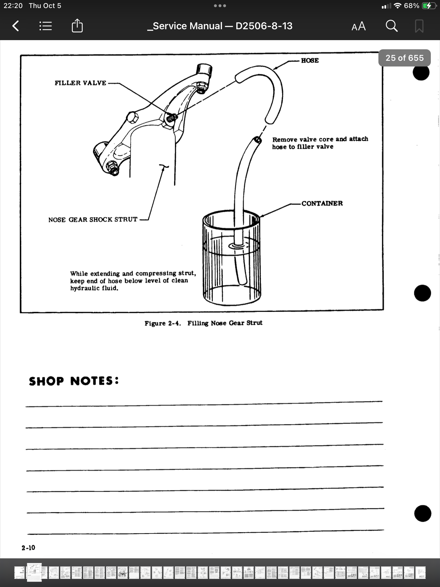

I would not recommend flying with a deflated nose strut.
On my G-model, the nose strut pressure specification is 35psi.
The procedure is pretty simple. I’ll try to post the pages from the g-model service manual. Nitrogen is best but air works too.
Pretty good article:
https://www.cessnaflyer.org/maintena...-ins-outs.html

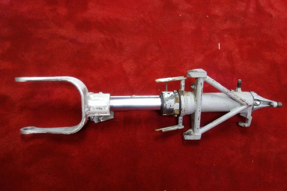

The cap on the valve should be able to be loosened with your fingers
You can see it in the picture attached
Frank
