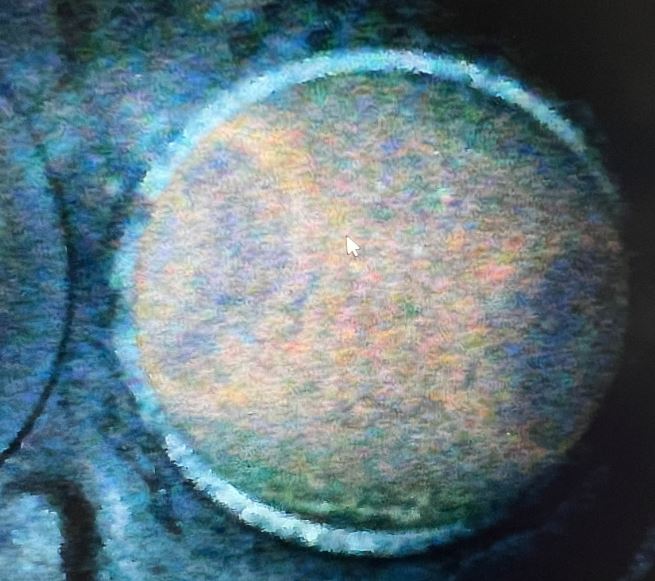

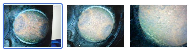

#3 cylinder, front engine, passenger side... 20 PSI. WHAT?
Borescope shows attached image for its exhaust valve.
So sad...
As you can see the valve is NOT rotating, and 20 PSI it is not closing all the way.
My gurus here tell me
The vale NOT rotating as it should,
'green edges' are from severe over-temp, aka a 'burnt offerings'
While one might be able to lap in place and pretty it all up,
the metal is cooked and WILL fracture at some point.
Sigh...

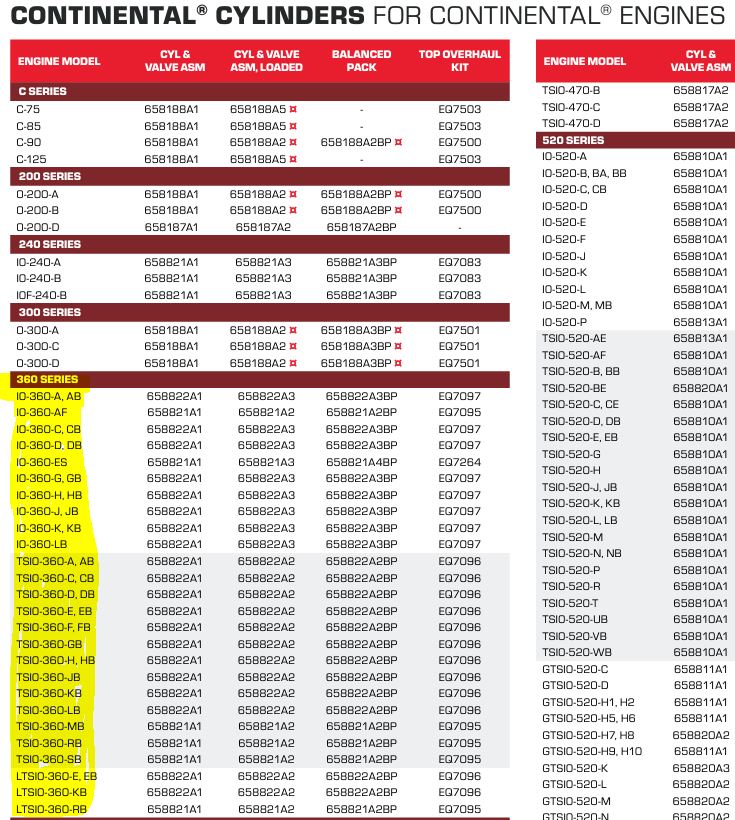

Here are some Continentals: 8 cylinders, 3 of which are chrome overhauls loaded and ready to go, one broken OH cylinder (use the parts to load another cylinder), the others are bare cylinders $1750 for everything: https://www.ebay.com/itm/255454370492
Says to "contact him for a better price" so I bet you could get it for $1500. If someone wanted to go in on something like this, I'd be a player. I'd love to have a spare OH sitting on the shelf. Turns out IO-360 and TSIO-360 use the same heads, same p/n and all.

Make sure you get the right Cylinder for your engine
You can confirm using continetal's website by entering the part # of the cylinder to see if it fits or your engine information to get the part # of the cylinder for your engine

I certainly don't want to lead anyone astray, so here is the cylinder compatibility chart directly from Continental:
Name:  Continental 360 cylinder part numbers.JPG
