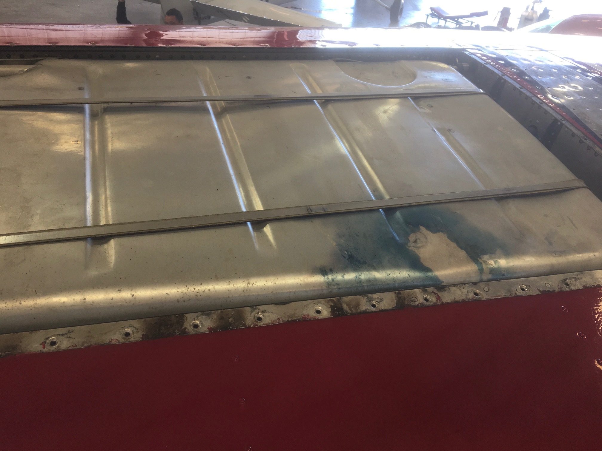

Posts: 437
This is what mine looked like. 1973 C337G about 2 1/2 years ago. Hopefully the pic attaches.
